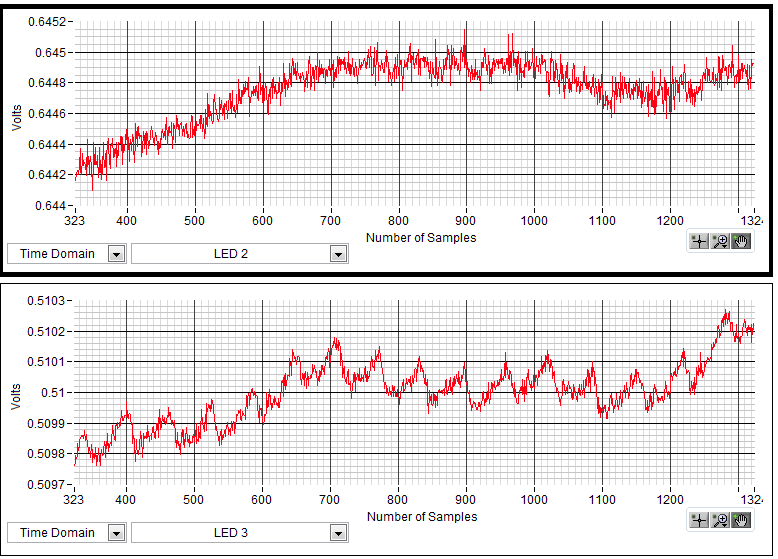

    Now I am trying to estimate SpO2 level using red and IR led. Green led is off. By tuning the parameters as
    LED 2 current = 30mA
    LED 3 current  = 20.8mA
    TIA Cf x TIA Gain = 5pF x 10K
    I get the following waveform. LED 3 is a typical ppg signal but I am not getting the write waveform on LED2
    Please guide me how can I get a typical ppg signal on LED 2 as well.
  • Hi Qasim,
    Is LED2 a Red LED?
    Can you first try at finger tip? This will make sure register settings are correct.
    You can also try to filter out the high frequency noise by doing moving average of few samples.
    PRabin

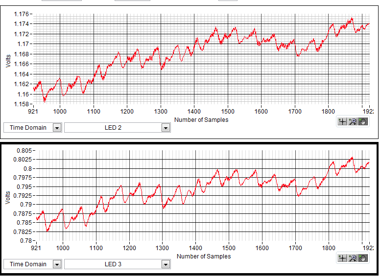

  • Hi Prabin,
    I got the following response at finger tip with parameter set as follow
    LED 2 current = 19.2mA
    LED 3 current  = 14.4mA
    TIA Cf x TIA Gain = 2.5pF x 100K
    TIA Cf_SEP x TIA Gain_SEP =2. 5pF x 10K
    OFFDAC LED2 = 6uA
    OFFDAC LED3 = 6uA

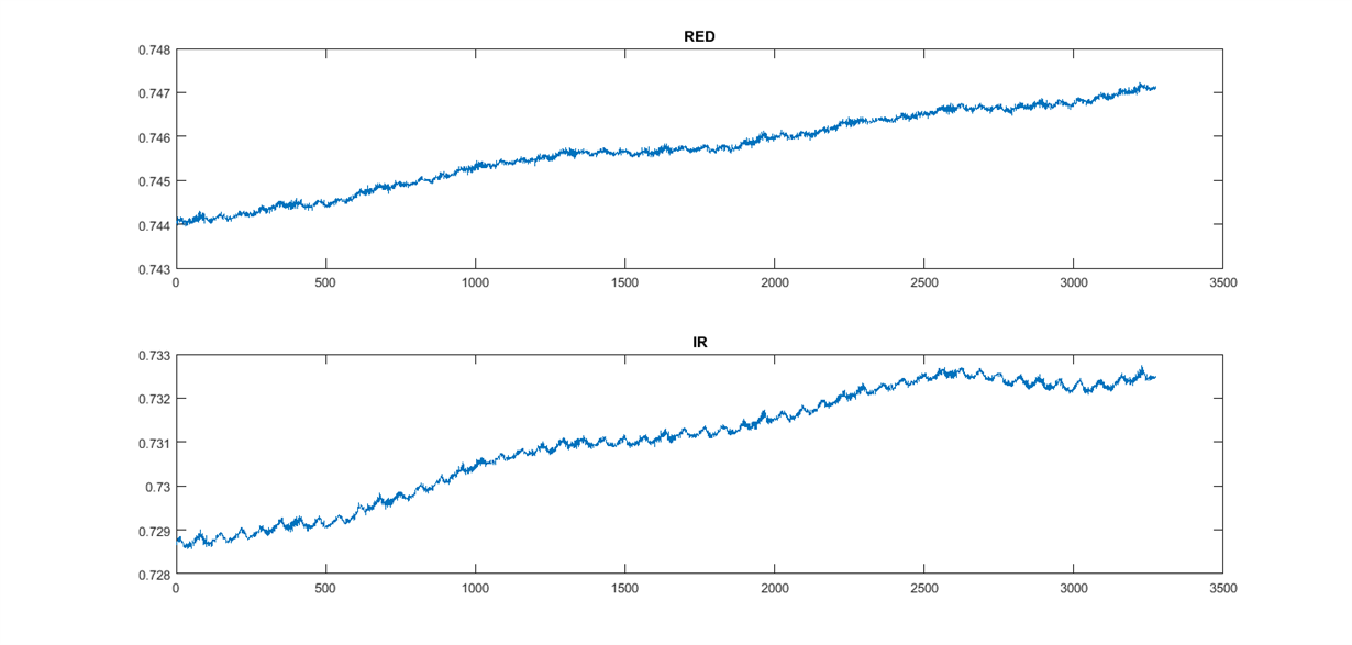

    After that I tried to get the waveform at wrist. I had to increase the LED2 Current to 25mA with other parameters same. I import the data on MATLAB and applied moving average filter. The results are shown below. Plots are from the MATLAB
    Still the signal is not fine. You can observe that the AC level of the signal is very low and signal is noisy also. Please what should I do further to get a good PPG signal as I got at finger tip.
  • Hi Qasim,
    Amount of the PPG signal being received totally depends on sensor location on the body ( due to obvious biological factors).
    That being said, following are my observation after seeing the waveform.
    1) DC level of the signal is ~0.73V. Are you setting the OFFSET DAC to negative -6uA or 6uA? Try to cancel as much DC as you can.
    2) Increase the LED current, so that more light can penetrate inside the skin.
    3) Can you look at the frequency spectrum of the signal. This is to find the noise source, hope you are not picking AC mains.
    4) Can you use LED-Ambient instead of just LED phase.
    Prabin.
  • Hi Prabin,
    Thanks for your response. Answer to your questions are as follows
    1) OFFSET DAC is set to -6uA.
    2) I will increase the LED current and check whether the results are better or not
    3) I don't think so I am getting the AC mains because during reading I operate my Laptop through battery by disconnecting the charger.
    4) Actually I am using your GUI for evaluation, so Is there any way that I can access LED 2 and LED 3 ambients. Becuase the log data contains only LED 1 ambient and other are LED phase only.
  • Hi Qasim,
    Out of 4 phases available, the phase where LED is off has the ambient information.
    You can save all 4 phase data using the data and subtract the Ambient in the excel sheet yourself.
    Prabin

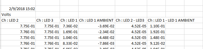

  • Hi Prabin,
    As you can see the channels that are available. Is LED 1 Ambient represents the ambient data for all LEDs? Like I have to do this LED2 - LED1 Ambient and LED3 - LED1 ambient. Is that right?
    Furthermore, why the TIA_SEP_GAIN affects the DC level of LED3, as mentioned in the GUI TIA_SEP_GAIN is for LED2.
  • Hi Qasim,
    Yes, you are correct regarding Ambient subtraction.
    When you enable separate gain, LED2 and LED3 will have one gain and LED1/LED1 Ambient will have another setting.
    For further detail please refer section 8.3.1.2 of the datasheet.
    Prabin
