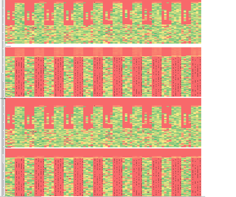

     Those helped me a lot in my project.let me share our setup for testing with you.You can see that in the image attached with this.the first pic shows a box with some pattern created in it.
    we just wanted to know the actual response of the opt8320 sensor.We then placed the opt8320 sensor pcb into the box and obtained a set of values.We then extracted the amplitude data from the 32 bit pixel data which we obtained from opt8320.We later copied the amplitude data into an excel sheet and with the help of conditional formatting color scales option, we colored the data.
    The data is being colored in a format such that , red color corresponds to amplitude zero ,peak values  green and an intermediate values are represented by yellow.
    i have attached those excel sheet pics too.
    the major doubt i have is that, why are we getting the value zero? Is it due to poor illumination or is it due to something else?What do these values ranging from zero to 4000 and above mean actually?Really what does this value zero actually mean?
    can you please help me regarding these doubts too.
  • Amal,
    It looks like you're making good progress, the raw data looked correct, but they are interleaved (and they should, indeed).  Zero amplitude can come from pixel saturation or very low illumination. Given your setup in the picture, pixel saturation due to close distance is more likely.  For debugging, it is best to separate out the pixel's amplitude, phase, ambient and flag into separate images; otherwise it will be very hard to see what's going on.   Our Voxel SDK unpack the various image types for you.  If you're not using it, you can still see how it is done.
