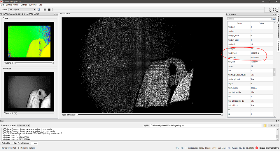

I am trying to calibrate the OPT8241 from the voxel viewer.
I start to create the parameters for the test.
I created a new profile in Voxel viewer (v0.9.10). The base is "Lens only".
I changed the value of mod_freq1 from "40MHz" to "30MHz" through "Parameters".
I shut down the viewer and run the viewer.
However, the value of mod_freq1 still remains at 40 MHz. How do I update this? Does this apply to frequency calibration?
JH Bae
  • Whenever you start VoxelViewer, the default profile will change registers, including mod_freq1 and mod_freq2. Try change the frequencies using Parameters window, then create a new profile (without doing any calibration). When you reopen Voxel Viewer next time, select that new profile.

    Where can I change and save to conf the frequency?
    You can find "Parameters" on the right side of the "Point Cloud" window in the viewer.
    I can find "mod_freq1" and "mod_freq2" here.
    I also tried this.
    Select "Lens only" and change the value of "mod_freq1" from 40MHz to 30MHz.
    Then create a new profile. Load a new profile. But it's 40MHz.
  • Unfortunately, for settings other than the calibration settings, you have to do the changes manually.
    It seems that you are using the "Lens only" profile present in the host. This profile will not have the correct Lens Parameters and you have to do lens calibration.

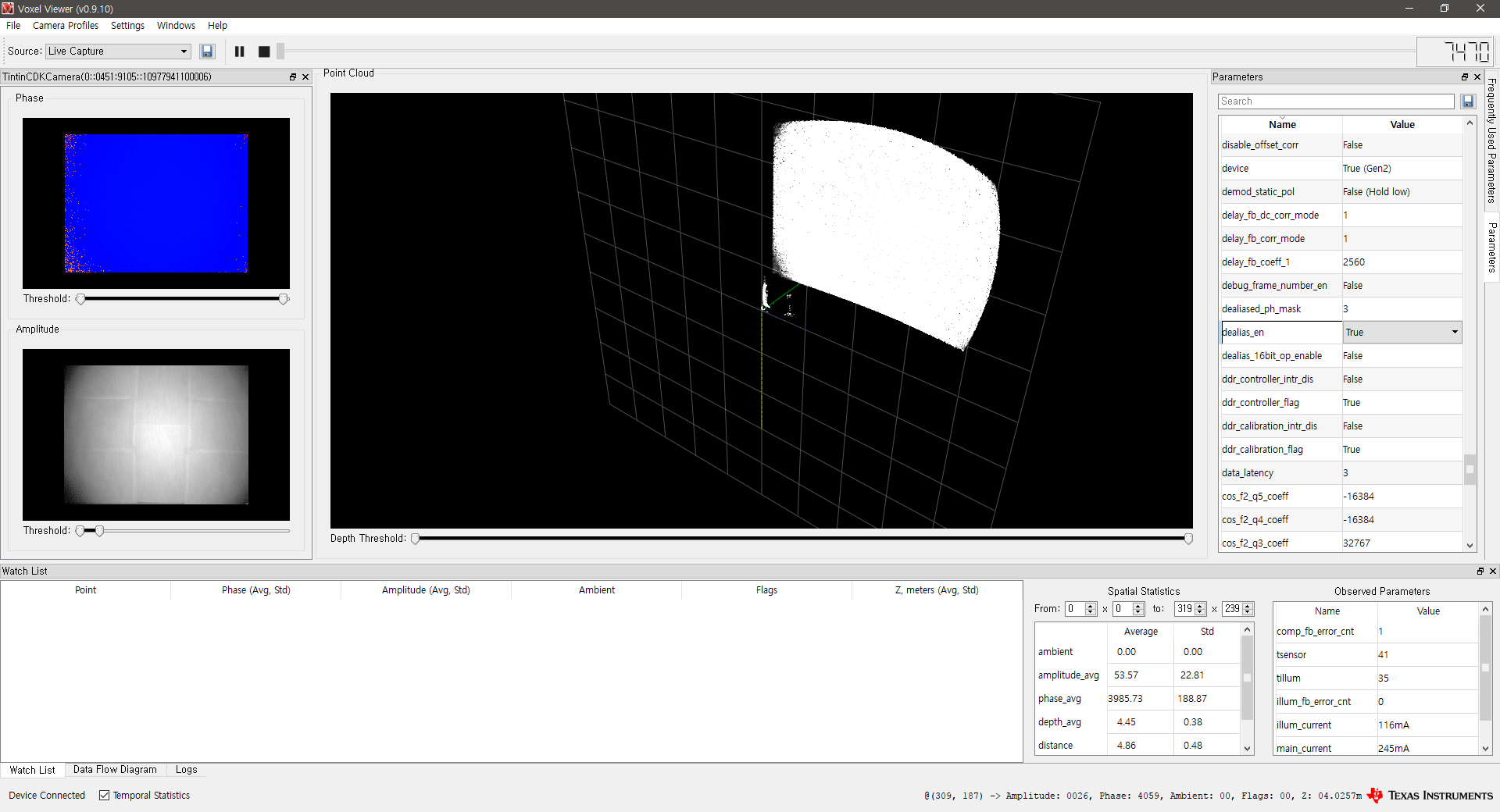

  • I have done your advice.
    However, if you set the dealias_en parameter to "False", I see a lot of line noise in the image.
    I perform cross-talk correction.
    However, there is no change in the image.
    If I set the dealias_en parameter to "TRUE", it will get a uniform image.
