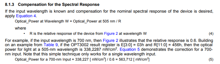

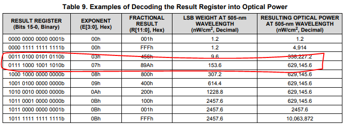

1. How is the red box calculated? If used
Optical_Power for a 505-nm Input = 2(E[3:0]) * R[11:0] * 1.2[ nW/cm2 ] The calculation result is inconsistent with the table
2. If the wavelength is 940nm, how should it be calculated? Is it calculated as follows
Optical_Power for a 940-nm Input = 2(E[3:0]) * R[11:0] * 1.2 / 0.11 [ nW/cm2 ]
