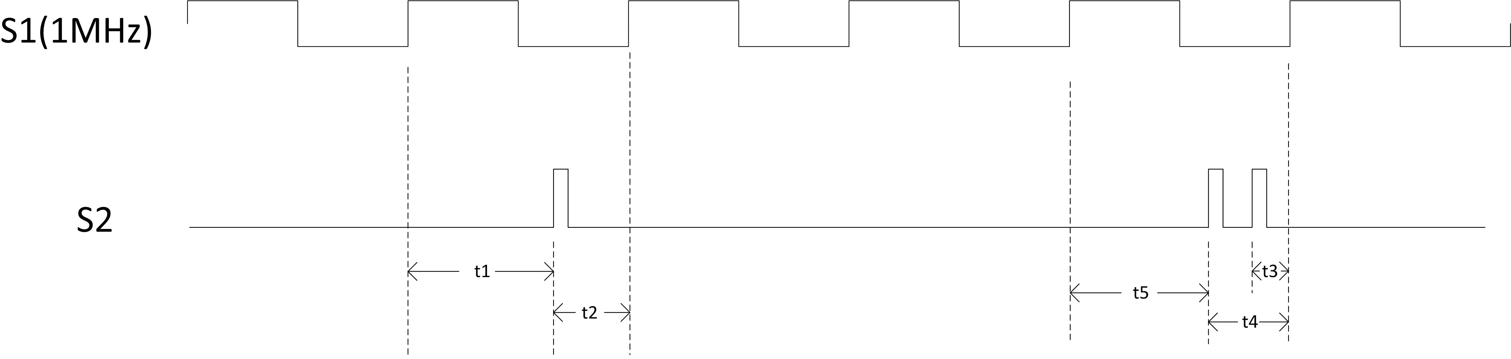

  • Hi Vishy,
    Chris and I are working on the same project which works like this:
    S1 is a constant source pulse at 1MHz, and for each s1 pulse, 0 ~ several excitation pulses will be excited (S2), we want to measure the time between the source pulse and the first (if any) excited signal (t1 and t5 in Figure).
    Since S1 works at a high frequency, we want to connect S2 to START of TDC7200 and S1 to STOP of TDC7200 regarding to the throughput of TDC7200. If one excited signal occurs after one source pulse, we can get t2 from TDC7200 and calculate t1=T-t2, where T is cycle of S1. But what if two or more excited signals occur after one source pulse? Clearly setting an overflow threshold is not a solution because usually t4-t3 is smaller than the expected result from TDC7200. Will we get t4 (all following START be ignored) or t3 (all previous START be ignored) from TDC7200 or something else? I hope I made myself clear. Thanks.
    Eric
  • Eric,
    Thanks for the explanation. I understand the question better now.
    I have not tried this exact situation as free-running START, STOP signals is not the recommended use model of this device. Looks to me, in your case, at least STOP is free-running. If possible, I would gate the STOP input to the device until a TRIGGER is provided.
    To your question I would think TDC7200 will measure t4 and ignore any other START while it is waiting for a STOP. And in this case, I assume the device sees the first START edge correctly.
    Vishy

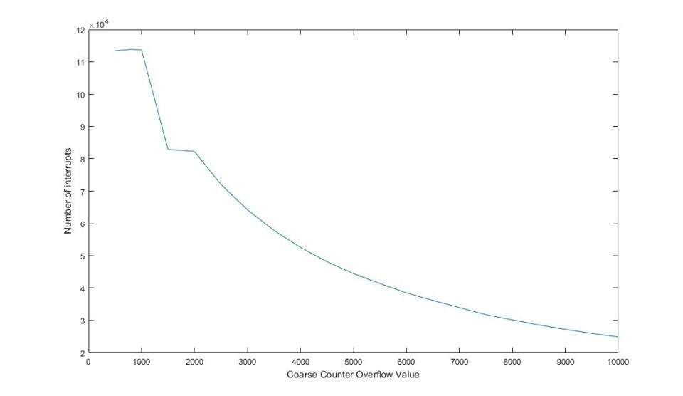

  • Hi Vishy,
    As you stated, a measurement period can be measured as followings:
    Case 1:  One START and one STOP => Period =  Trigger to Start time + Start to Stop1 time + Stop to INTB time + Results Readout time
    Case 2: One START and no STOP (overflow) => Period =  Trigger to Start time + Start to overflow INTB time + Results Readout time
    We performed the experiment to verify the speed of TDC7200:
    - Connect TRIGG to START
    - Do not give STOP signal
    - Configure OVERFLOW register
    - Skip the Readout time
    The graph shows the relationship between the number of interrupts over the value of OVERFLOW COUNTER register.
    Based on the example result on Page 16 of TDC7200 Manual, TIME1 = 4175 at CLOCK = 8MHz and CALIBRATION_PERIODS = 10 corresponds to 247ns..
    We think that OVERFLOW = 1000 can be interpreted to  STOP at 247 * 1000/4175 = 59ns and OVERFLOW = 8500 is translated to STOP at 500ns. However, the experiment results look different. We could not reach 170K points even though we did not perform the read out.
    Could you explain this issues?
    Thank you very much.
    --Truong
