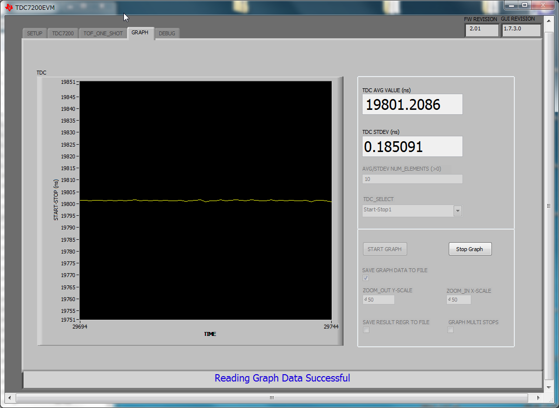

TDC7200EVM GUI save to file interval setting ( I want to set it less than 100mS --- 20uS = 50ksps)
Other Parts Discussed in Thread: TDC7200EVM, TDC7200, MSP-EXP430F5529LP, MSP430F5529
I can save the time span data to file in TDC7200EVM GUI all right.
But, there is one porblem.
I want to save the time span data (around 17uS) every 20uS.
I checked the log file and found only 5 data per second = every 200mS.
I found the setting but the minimum setting is 100mS.
Would you please show me how to save the time span data every 20uS = 50ksps?
Trigger update freq = 100mS minmum = 10sps max
Save graph data to file.

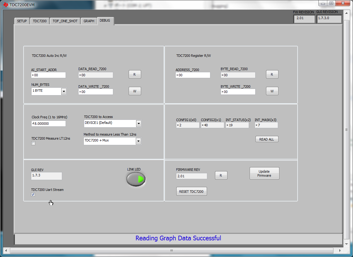

  • I decided to follow your advice.

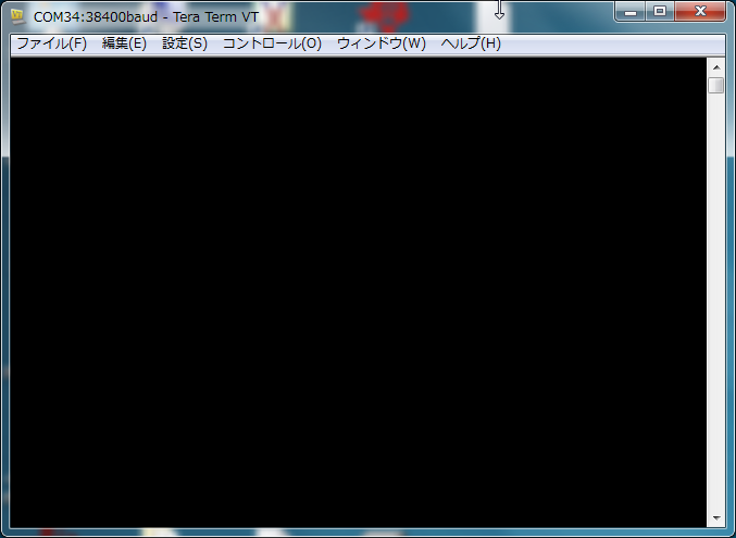

    I use CCS to debug TDC7200EVM_USB.
    To check the UART,  I checked the COM port.
    I opened the MSP Application UART1(COM34) using TeraTerm.
    I set the baudrate at 38.4kbps.
    I started the graph.
    I checked the TDC7200 Uart Stream.
    But, nothing is coming to TeraTerm window.
    What should I do?
  • Your steps look correct. Please make sure your tera term settings are fine. You can also check if data is coming from TOF_ONE_SHOT tab. If for any reason you disconnect and reconnect the GUI, you  have to unselect and select the "TDC7200 Uart Stream" option again because the firmware loses the setting after a disconnect /reconnect.
    I tried it now. See some screen shots below to help. Thanks.

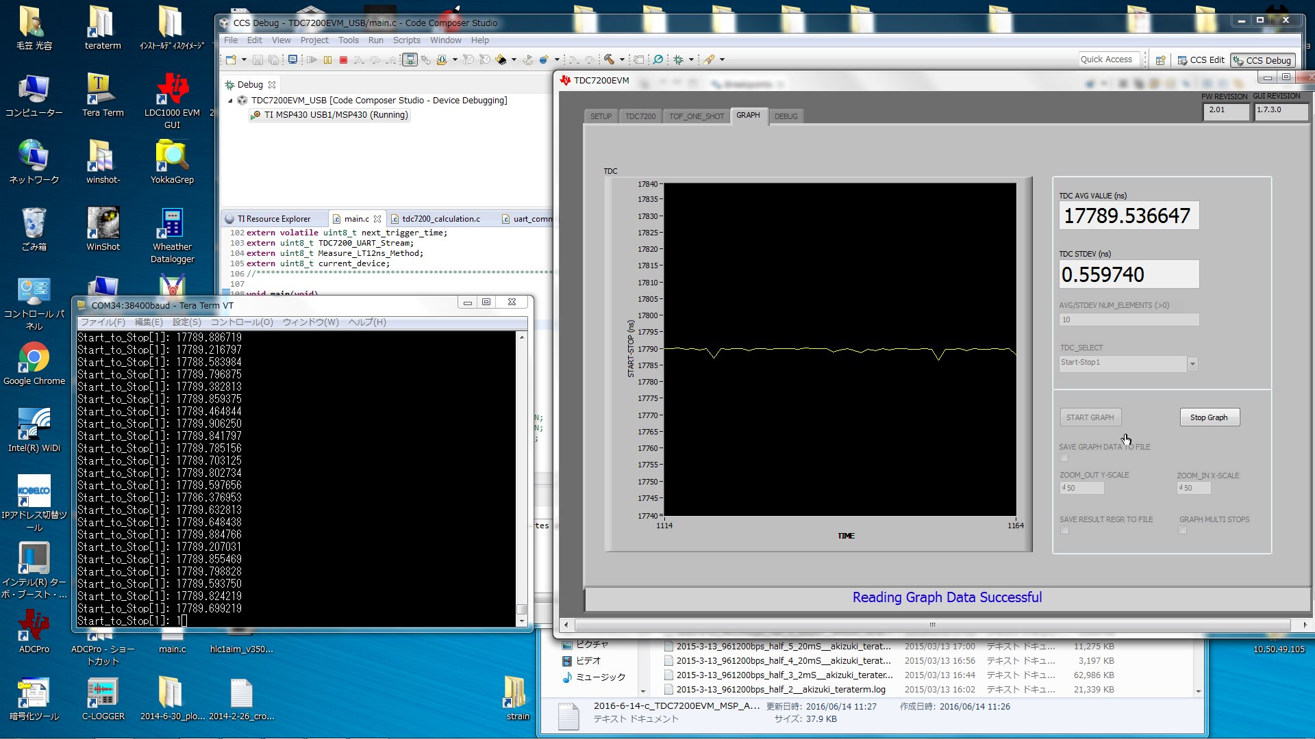

  • As a matter of fact, I tried it on CodeComposerStudio Debugger yesterday.
    I got no data on TeraTerm yesterday.
    (CCS Debugger seems to Use the back channel UART somehow, I guess.)
    Today, I tried without CCS Debugger. Just plug in the TDC7200EVM board and started the GUI and TeraTerm.
    I got data stream on the TeraTerm window all right.
    Thank you very much for your help!
    I think now I can proceed with changing the parameters you mentioned.

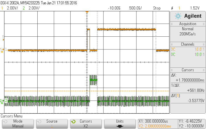

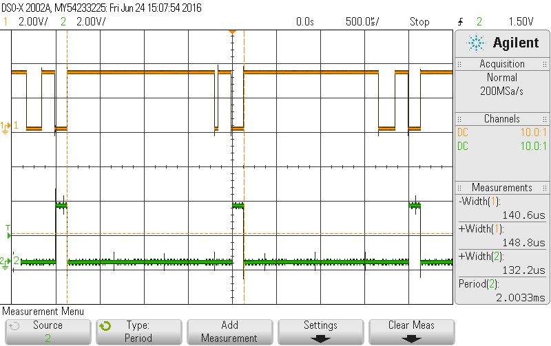

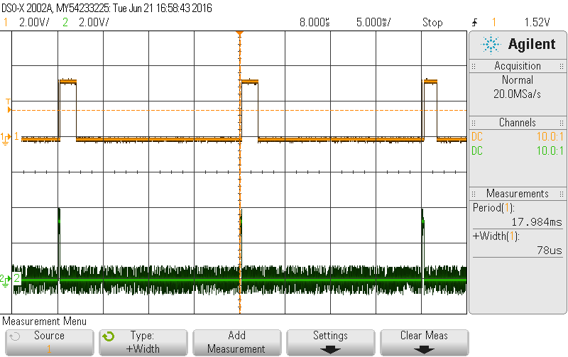

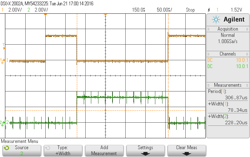

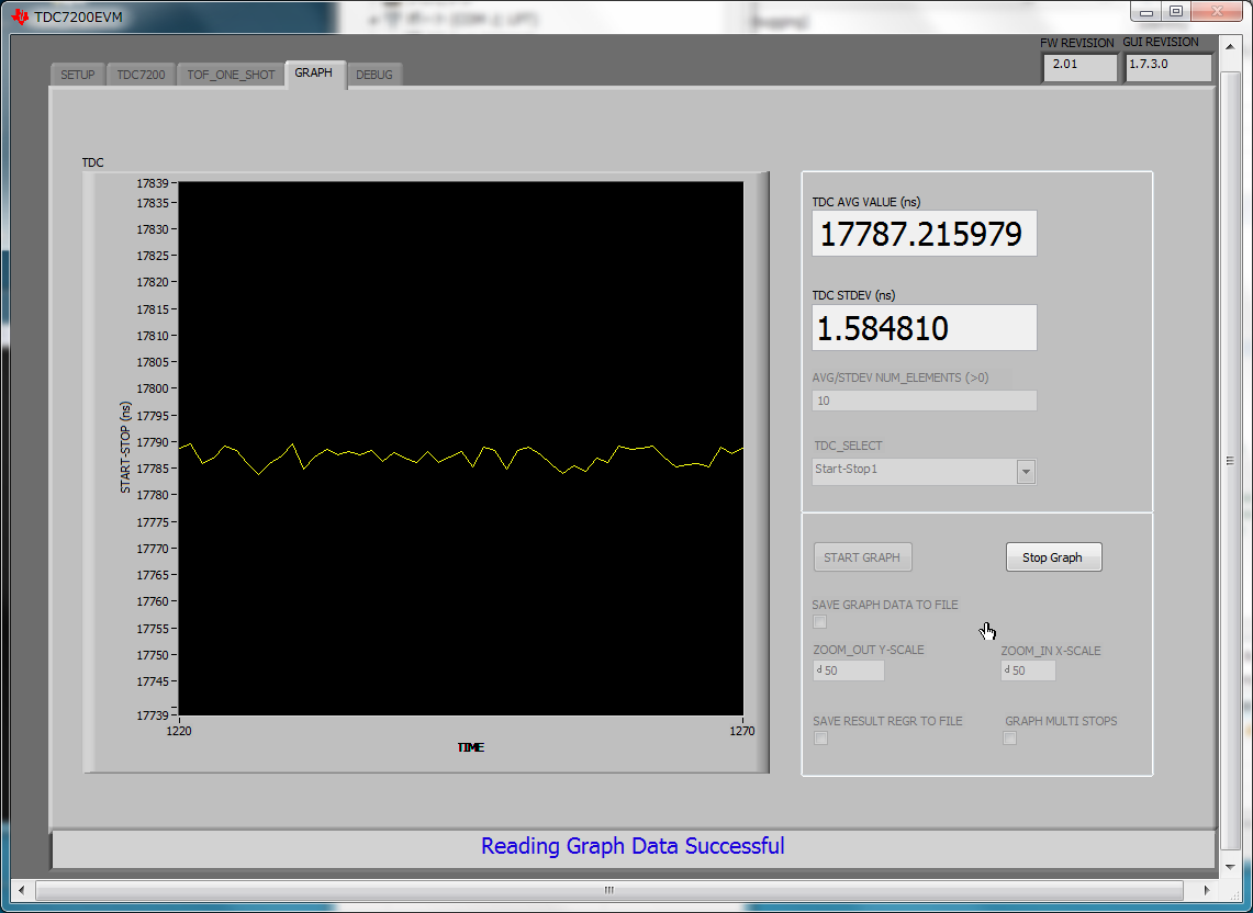

  • I think I tried all the suggestions you had given me.
    Now I can get the data at 10mS interval all right. ( 100sps )
    There are two strange points.
    (a) Maximum baudrate is 115200bps.
    I tried 230400bps.
    Although the signal at the TxD port looks good, Teraterm show strange characters.
    Maybe I hit the back channel interface's speed limit.
    (b) Interval is twice of the setting.
    When I set 10mS, data is coming at 20mS interval.
    When I set 5mS, data is coming at 10mS interval.
    When I set less than 2.5mS, data is coming at 6.8mS interval.
    Maybe I hit the 6.8mS interval time limit.
    f = 147 Hz = 147sps is the best.
    I want to accomplish my goal of 20uS interval ( f = 50kHz ).
    But maybe this is the limit of TDC7200EVM.
    Maybe I should design new board with faster USB serial adapter.
    Maybe I should use stronger MPU.
    If you have more suggestion, please give them to me!
    Below are the programs I changed and the Teraterm logs I got.

  • I tried your idea to measure the time using GPIO.
    In main.c, I add these lines below.
    P4DIR |= BIT1; // P4.1 = output kegasa
    P4OUT |= BIT1; // P4.1 = output high kegasa
    P8DIR |= BIT1; // P8.1 = output kegasa
    P8OUT |= BIT1; // P8.1 = output high kegasa
    In tdc7200_calculation.c, I changed the tdc7200_calc() by adding some lines.
    void tdc7200_calc(uint8_t *buf, uint8_t dev)
    P4OUT &= ~BIT1 ; // P4.1 = low kegasa
    P8OUT &= ~BIT1 ; // P8.1 = low kegasa
    P4OUT |= BIT1 ; // P4.1 = high kegasa
    tdc7200_build_mreg(buf);
    P8OUT |= BIT1 ; // P8.1 = high kegasa
    tdc7200_start2stopn(dev);
    print_start2stopn();
    tdc7200_calc is running every 20mS.  (setting is 10mS)
    It took 78uS to read the all the measure register = 39 byte.
    I must omit some of the register reading process to do it in 20uS.
    It took 228uS to calculate time.
    I need more CPU power to calculate the time spans in 20uS,
    It took 1.78mS to print out the data to UART.
    I need faster UART to send them in 20uS.

  • Thank you very much for your advice!
    I change some of the source code following your advice.
    Now, I can get data at 500sps (2mS).  More than 3 times faster than the last result (6.8mS)!
    I'll tune up some more software this week, and try MSP432 next month.
    I started @100mS, Now @2mS, 50 times faster!
    My goal is @20uS, 100 times faster to go!
    Below are the part of the souce code I changed.
