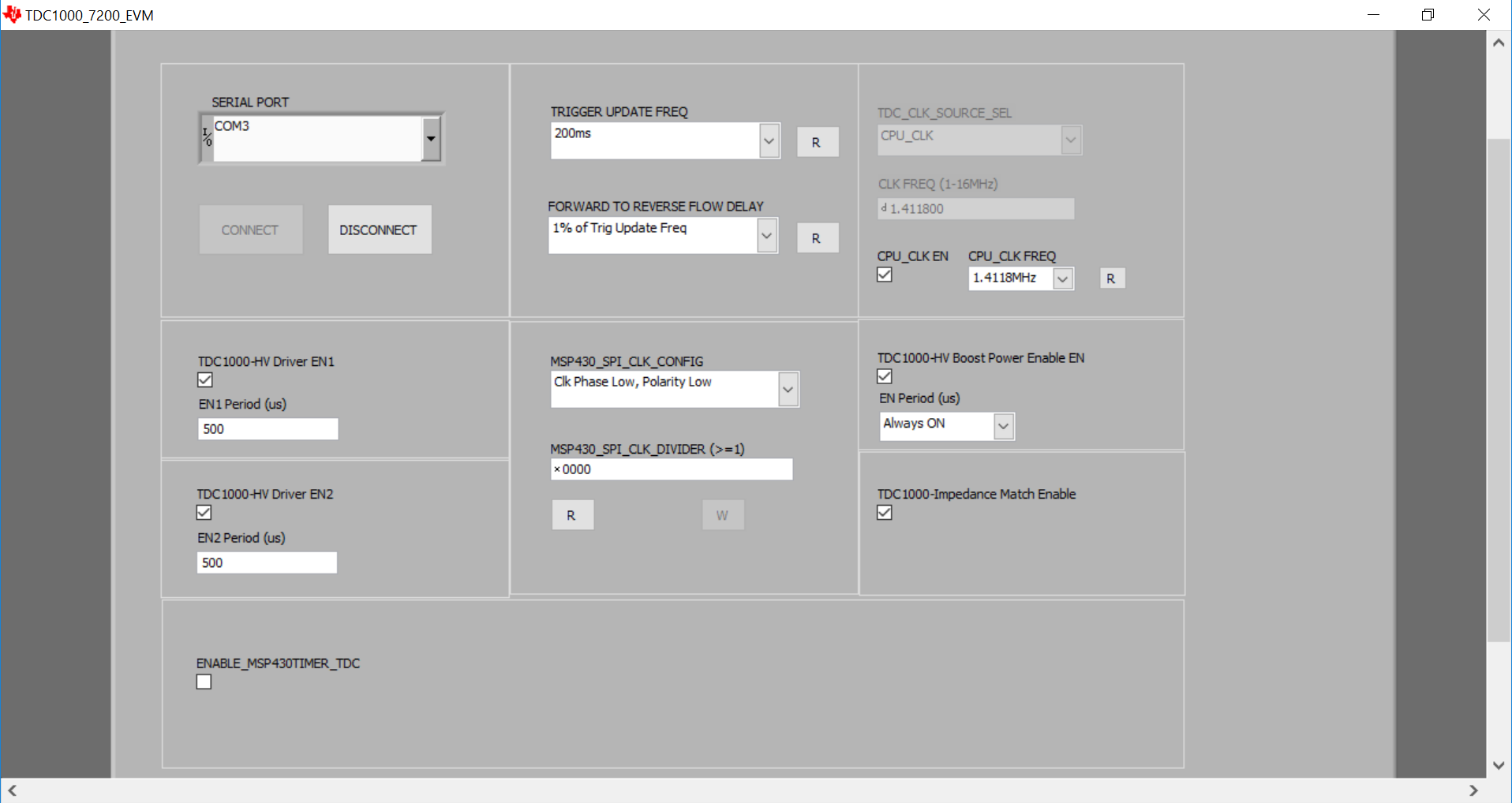

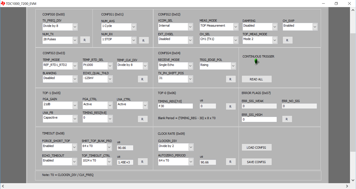

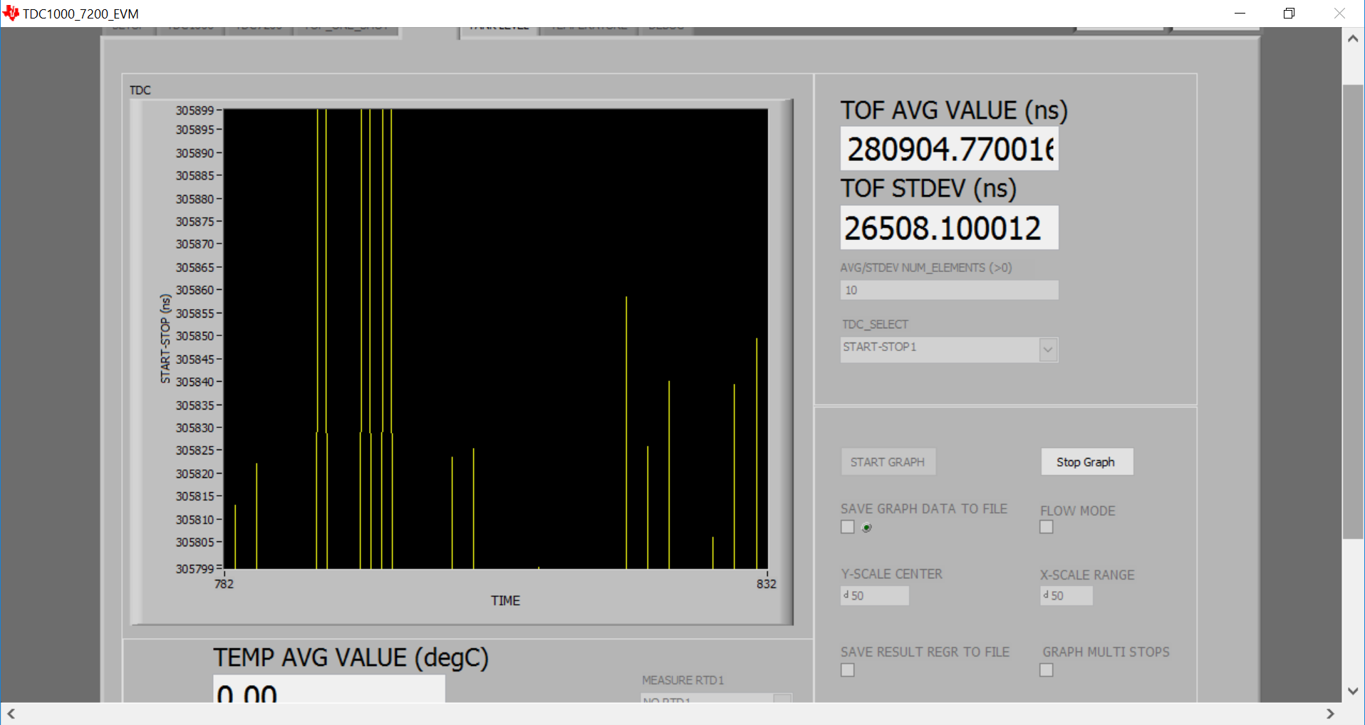

I am using a 175 KHz transducer in an anemometer project and having issues with the TOF measurement with my setup.   With the attached configuration, the TOF measurement and std don't appear correct for sea level, 20C at a distance of 7.62cm between transducers.   I've mounted the transducers so the LOS between the two are clear of obstructions.   Can you please advise?

    First I would uncheck the TDC1000 Impedance Match enable on the setup tab. Also, try decreasing the HV driver EN period. With 28 pulses at 175khz, your excitation period is only about 160us. You could set it to 200us to add a bit of buffer. Start there, and monitor your START, STOP, and COMPIN signals with an oscilloscope. This will give you a better idea of whether your STOPs are triggering properly.
  • Hi Scott,
    I unchecked the Imp Match box and decreased the EN period to 200 us. I'm still having the same issue. When I do get things configured to a point where I can get a stop signal and TOF, I think its actually induced by noise triggering the stop because when I move the change the transducer distance, the COMP signal doesn't shift and TOF remains the same. Any other guidance?

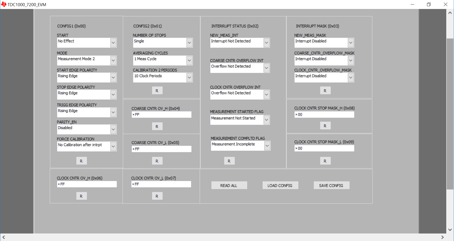

  • Hi Anthony,
    To start with, you will need to modify the bandpass filter on the receive path between the PGA output and COMPIN. The GASEVM bandpass filter is set for 58khz-300khz. You may still see some signal, but it will be very difficult to get a good SNR outside of the passband of the filter.
    I've attached a setup file to try. You will likely need to play with the blanking settings, but this will give you a start.
