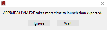

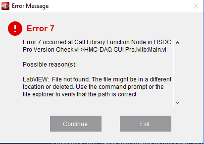

I am running the python "HSDCPro Automation DLL ADC Example" script (found in the HSDC Pro Automation directory) and would like the entire system to function in the background, however after the script selects the ADC and downloads the firmware, I get a popup message (see Image 1 below) that until now I had just clicked Continue to move onto loading the AFE58JD28 GUI (So my problem begins when running the AFE58JD28 software). Since I am trying to run the automation script I need to avoid having to manually click Continue. If it is not clicked, the timeout expires, and the program is halted (see Image 2 below). Any help would be much appreciated.

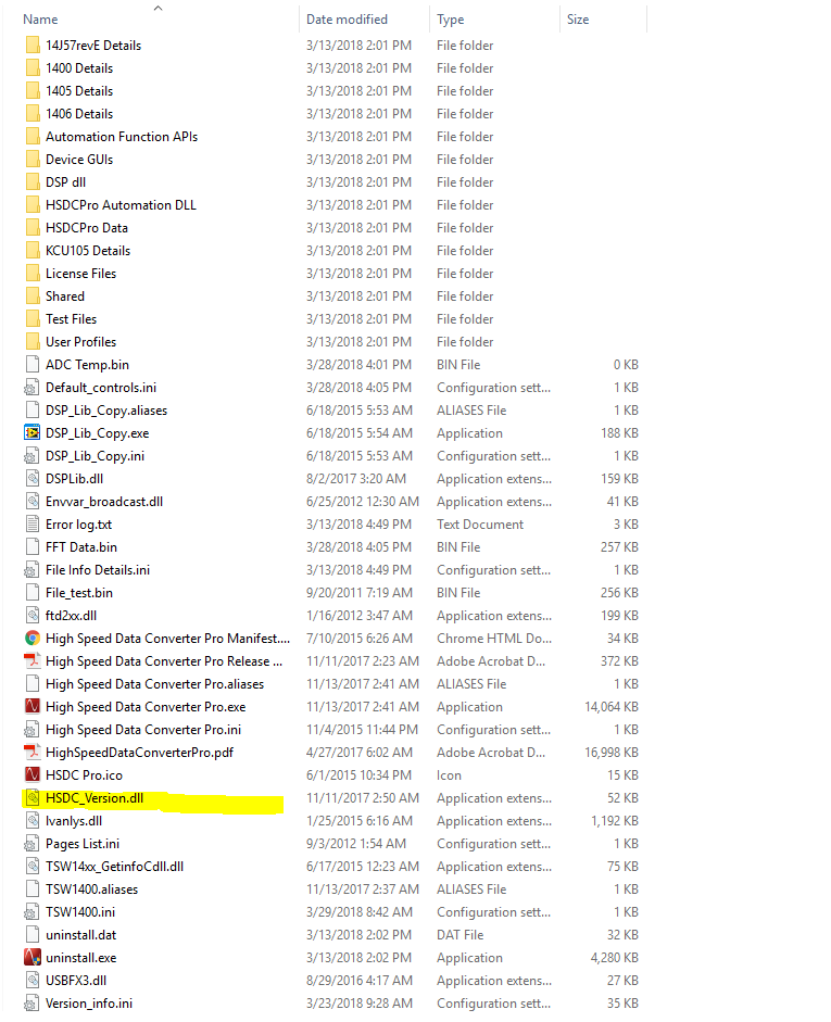

  • Hi Jacob,
    We are thinking that a possible reason for this issue could be if the “HSDC_Version.dll” file is missing in the below location which comes along with HSDC Pro GUI. C:\Program Files (x86)\Texas Instruments\High Speed Data Converter Pro\HSDC_Version.dll
    Can you clarify the following?
    1. Screenshot of the files present in the HSDC Pro directory to verify whether “HSDC_Version.dll” file is present or not.
    2. Does this error occur when the GUI is launched by selecting the ADC in the HSDC Pro dropdown or it occurs only during Python scripting?
    3. Would it be possible to use HSDC Pro GUI version 4.5 since we have done extensive testing using that version which was the then-current version of the HSDC Pro GUI at the time of the AFE58JD28EVM release?
  • Praveen,
    Thank you for looking into this. To answer your questions:
    1. I checked the directory and did find the "HSDC_Version.dll" file there (screenshot below)
    2. This error occurs when the GUI is launched and when running the python script.
    3. I am willing to use version 4.5, but I have not been able to locate it on your website. Could you send me a link to it?

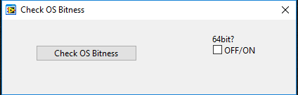

  • Hi Jacob,
    The error 7 usually occurs if the HSDC_Version.dll is not located in the directory.
    Can you please run the attached exe and provide a screenshot of the exe after execution?
    /cfs-file/__key/communityserver-discussions-components-files/1023/8877.Check-OS-Bitness.zip
    After launching the application, you will need to click on the 'Check OS Bitness'.
    Once the button is clicked, we would like to know if the check box '64bit' got checked.
    Please send us the snapshot of the GUI as before.

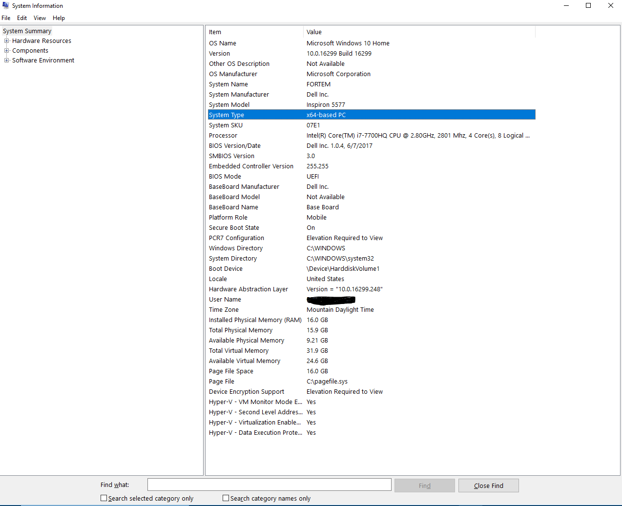

  • Praveen,
    Here is the screenshot of the "Check OS Bitness" program. The box was not checked after clicking the button (several times).
    However, in 'System Information' on my Windows 10 machine, it shows that it is 64-bit (x86) (see screenshot below).
  • Hi Jacob,
    Can you please run the attached “Check OS Bitness.exe” exe (v1.1) and provide the screen shot of the GUI?
    /cfs-file/__key/communityserver-discussions-components-files/1023/5635.Check-OS-Bitness_5F00_V1.1.zip

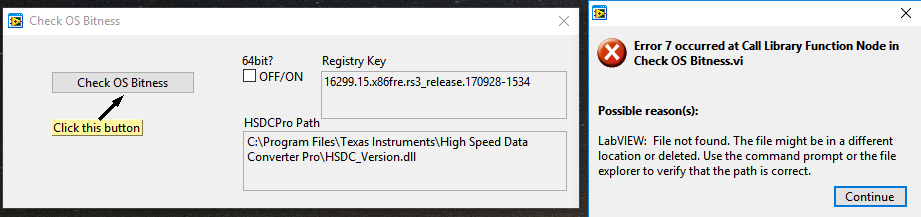

  • Here is the screenshot:
  • Jacob,
    Thanks for forwarding the screenshot.
    We have identified that this is a software bug and we are looking into fixing this as soon as possible.
    As a quick workaround and to continue with your evaluation, can you create a directory 'C:\Program Files\Texas Instruments\High Speed Data Converter Pro' and copy the DLL file 'HSDC_Version.dll' from 'C:\Program Files (x86)\Texas Instruments\High Speed Data Converter Pro' to the newly created directory?

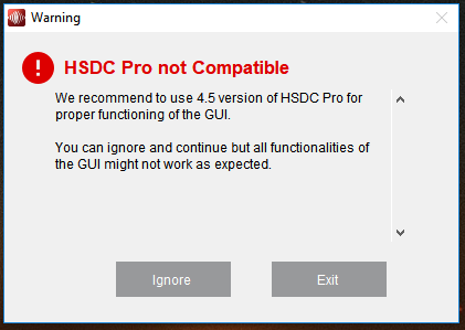

  • I copied the DLL file to the newly created directory, and when running HSDC Pro, I now get this error/warning every time I connect to the ADC. I am not too worried about it because it is a temporary 'work-around' but I thought I would let you know what happened on my end.
  • Hi Jacob,
    Thanks for letting me know.
    We have extensively tested the AFE58JD28EVM with HSDC Pro Version 4.5.
    So we added this warning note to let the user know about this.
    You can either switch to HSDC Pro v4.5 or choose to ignore this warning to proceed.

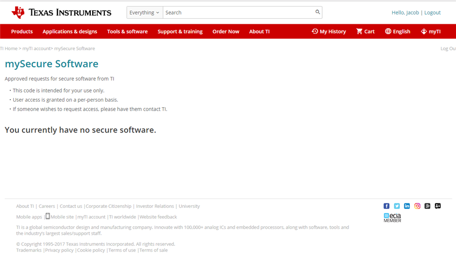

  • You should be able to find it in the mySecure software folder at www.ti.com/myti
  • Praveen,
    I located 'my secure software' in myTI account > My activity > mySecure software but it is currently empty (see below). Are you able to grant me access to that software?
    I have also tried a link that was included in this TI forum but it no longer exists.
    Thank you for your help,
  • Praveen,
    I installed the new software (HSDC Pro v4.5 and AFE58JD26_EVM v1.0.4) and copied the new HSDC_Version.dll (the one located in C:/Program Files (x86)/Texas Instruments/High Speed Data Converter Pro/) into the temporary directory you had me create previously (C:/Program Files/Texas Instruments/High Speed Data Converter Pro/) and I no longer get the Error 7 message.
    However, if delete the temporary directory, I get the Error 7 message again. I was under the impression that the 'temporary directory' was a temporary fix. Is this the case?
  • Hi Jacob,
    I'm from Praveen's team. Please do not delete the temporary directory. It needs to be there to run HSDCPro without any error as you have mentioned. We have identified the root cause of this issue and unfortunately it seems to be due to the way that Microsoft has changed the way that registry access is provided in the recent WIN 10 builds (please see here for more details). We will be fixing this and releasing a new version soon. Please let us know if you have any questions.
