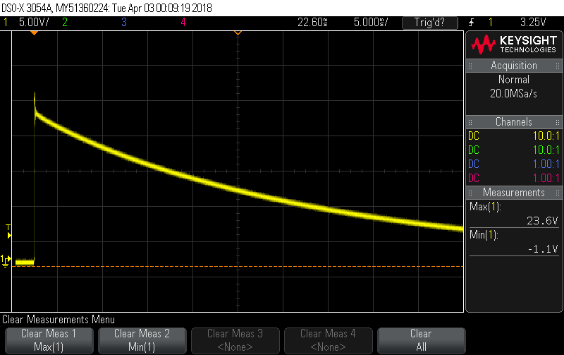

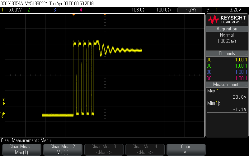

I am using the PGA460 in direct drive mode with a 40kHz transducer with a rather short decay time and am having difficulty obtaining an accurate frequency reading using the system diagnostics. I have played with the Window Length and Start Time, but can't seem to get a "good" reading. Any recommendations for getting the most accurate frequency reading?

    Thank you for your very detailed and useful answer. However, i don't think the diode will help in my case.
    I think part of my problem may be how little AC swing there is for my transducer when it is oscillating freely. Comparing my scope captures to your examples you can see that for my transducer the AC component comes nowhere near zero before it decays away. The first image is zoomed in, while the second is a very zoomed out version.

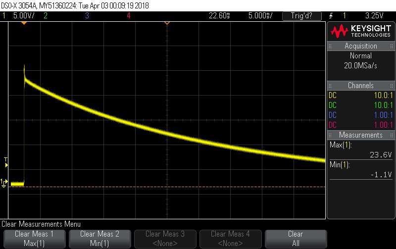

  • Hi Akeem,
    Yes, I temporarily had the bleeder resistor removed in an effort to obtain an accurate frequency measurement.
    Below is how it looks with a bleeder resistor at the transducer (yellow) and at the Test Pin with the Analog Front End (green)
    When trying to measure the frequency on the oscilloscope with the Test signal, there is little to no consistency in measurements from period to period.
    Do you believe I should be able to obtain an accurate measurement based on what you see?
  • Hi Andrew,
    The waveform as you have shown does complicate the frequency diagnostic measurement. I highly recommend that you use the series forward diode at the OUTx pin connected to the transducer-positive terminal to enable full peak-to-peak swing during decay.
    The frequency diagnostic feature relies on the zero-crossing time of the decay profile. The external AC coupling capacitor on the INP path proves to be effective since your AFE output still toggles during decay, but adding the forward diode will improve the reliability/consistency of the measurement.
  • Hi Akeem,
    Sorry I didn't specify. That waveform is WITH the forward diode at the OUTA pin, so I guess this might be the best I can get, unless you have any other recommendations.
