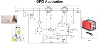

Hi team,
My customer is using AFE3010, but they have an question on the load switch (relay) placement, this shall be placed before relay or behind?, it seems require 2 CT circuit, do we have other suitable solution?
  • Hello Oliver,
    The AFE3010 needs to be placed behind the load switch (so on the line side, not the load side). The reason is so the AFE3010 can still be powered up and running self-tests, if the load switch is opened, or else user would not know if the GFCI is working before closing the load switch so they can power and use their loads (toaster or shaver as shown in image).
    If manufacturer wants the AFE3010 to be able to sense neutral-to-ground (N-G) faults, then they must use two CTs. If they don't care about sensing N-G faults, they could remove the 200:1 CT entirely and system will work normally and sense hot-ground faults, but it will not be able to sense N-G faults.
    Hope this helps.
    Peter
