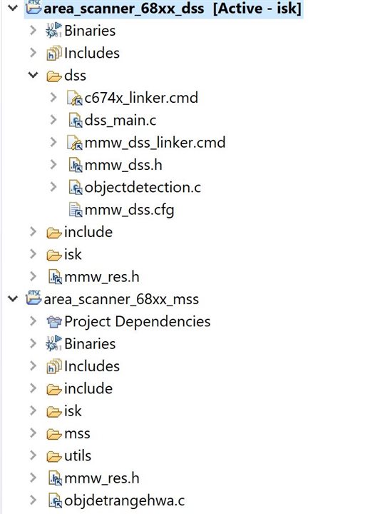

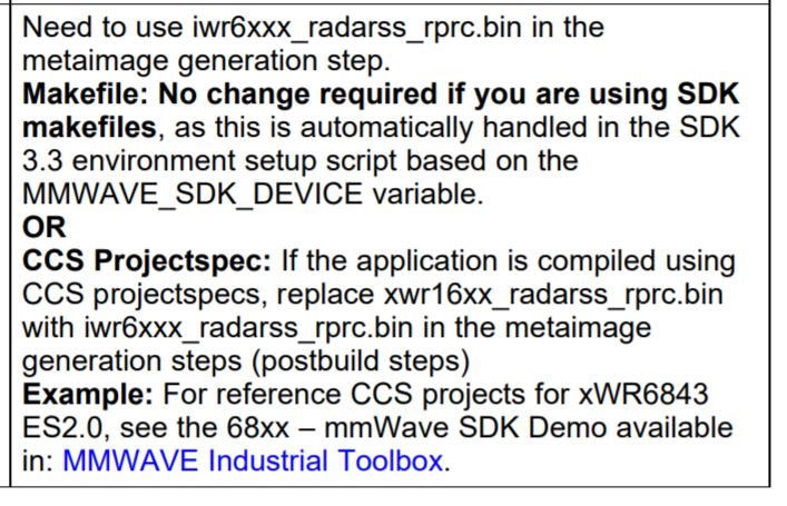

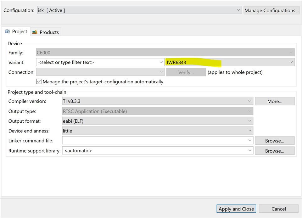

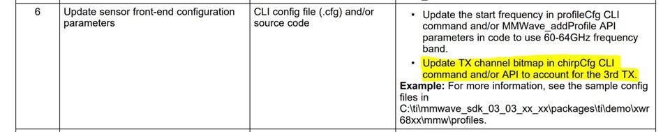

I have only AWR1843 and I need to to port Area Scanner demo in industrial toolbox from IWR6843 to AWR1843. I know it's portable but I am little confused how to port the whole firmware?
