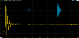

TDC1000-C2000EVM: As shown in the figure below, I used the TDC1000-C2000EVM for sound speed measurements, and in yellow I connected the TX1/RX2 signals directly to the oscilloscope. The other is the blue one is the COMPIN signal. The latter signal I am not

As shown in the figure below, I used the TDC1000-C2000EVM for sound speed measurements, and in yellow I connected the TX1/RX2 signals directly to the oscilloscope. The other is the blue one is the COMPIN signal. The latter signal I am not sure if it is an echo signal. Because these signals are constantly moving without me changing the distance the ultrasound travels. The signal in the picture is a transient signal that I intercepted.

    Thank you for your question. Can you provide some more info on your application? Such as what is the fixed distance you are trying to measure, is this a water coupled application, frequency of transducer, as well as your device settings.
    And I am not sure which signal you are referring to from the image, but if you could please circle or identify which one you believe to be your return echo that could be helpful in trying to understand your question.

  • 1. In the figure below, the waveform marked in red seems to be an echo signal, but the signal is constantly moving with time. I conducted the experiment underwater, and the measurement distance was about 10cm.
    2. The resonant frequency of the sensor is about 1M.
    3. The configuration of the upper computer is shown in the figure.
    4. I have adjusted the upper computer configuration and various settings numerous times now, but still no results. I am not sure if there is something wrong with the evaluation board. Or is there something wrong with my configuration.

    At about 10cm it should be the about the third waverform that you are seeing in your COMPIN pin. ToF = (2* 10cm)/(1480 m/s) yields a time of flight of about 135us.
    I performed a similar test with a 1MHz transducer with 10cm of water. Unfortunately I could not use a metal wall since I do not have a tank to accommodate for this and I mounted my transducer at the outside bottom of the tank, since I do not have a transducer rated for operation inside the water. My settings and setup can be seen below this yielded a ToF result of 136us:
    Here is a scope capture of this setup:
    As you can see I am also obtaining some noise possibly the transducer still ringing at the beginning of my measurement but it was not enough to trigger the signal. I noticed that on your setup you have FORCE_SHORT_TOF enabled, this will cause the device to begin detection quickly after the burst is complete. You want to avoid this because the device will then trigger on the transducers ringing. This is why its imperative to calculate the timing needed for your signal and calibrate your system to listening window at the appropriate time.
    If I want to avoid listening to objects early on I can shift my listening window to begin at a later time. I can do this by changing the values of TIMING_REG in the following instance I changed the value from my previous 0us to 40us, this was done by increasing the value of TIMING_REG[7:0] to a value of 70. It yielded the following results:
    As seen, the COMPIN will not get enabled until the listening window is active ignoring the noise or false echoes. As far as why you are getting incorrect echoes, please ensure the frequency of the transducer is correct, ensure that the device is actually transmitting the pulses, also verify that the device is rated to be used inside the water tank, you can also test a different 1MHz transducer. The configurations on my board are the same as the out of the box configurations.

  • Another suggestion I have is to use the TOF_ONE_SHOT tab instead of the continuous mode. My concern is that your signal keeps changing because you are seeing multiple echoes reflecting inside the tank due to the excitation being generated constantly. This might help eliminate this issue if that is what is happening.

  • Hello, the following video is the video when I test, the test phenomenon as shown in the video. The yellow one in the oscilloscope is the START signal, the green one is the STOP signal, and the orange one is the COMPIN signal.

    Thanks for the video, were you able to test using in the TOF_ONE_SHOT, this will just transmit one measurement unlike the graph mode which enables the continuous mode and sends measurements every couple of milliseconds. When doing this make sure to also disable the continuous measurement on the TDC1000 page of the GUI. This will help us troubleshoot better, I think it will allow you to see how the graph varies through each measurements and how to make proper adjustments to your settings as well see if the variance is due to any other echoes reflecting through the tank. I see some variance in the noise in my measurements but its not enough to trigger the comparator.
    I did notice that in the settings I see you have the gain at 21dB for the PGA. When I set the gain at that level for a 10cm measurement I was getting incorrect results (STOP was triggering too early) so make sure to adjust this accordingly. Also do not forget to update the value for TIMING_REG[7:0] to something higher than 30. This will prevent the measurement from being triggered during the ringing period.
    Have you been able to test another transducer? This will help ensure to make sure that the issue exists across other transducers and not just the one you are using at the moment. You can also try connecting the transducer to a different channel to see if maybe that makes a difference to your measurement, if you do this don't forget to change the CH_SEL option on the GUI. I do not see much issues with your configuration so please make sure to test the things I suggested.
