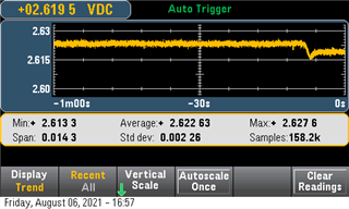

I'm developing a current sensor using a toroid in magnetic steel, the same used for classical 5A transformer. I made 1000 turns with an inductance of 380 mH. The DRV421 is inside a slot created in the core as you can see in the photo attached.
The DRV421 is powered at 5V. The shunt is 100 Ohm.
If I leave with no current, i see this in my multimeter:
However, if I only put my chair (with some parts in metal) near to the sensor, the data output changes a lot.
It seems as if the sensor is able to capture the earth magnetic field, and in some way the metal chair changes this field. Do you think my idea could be correct?
It seems as if it is necessary to add a shield to the toroid. Where should I put the shield? What material do you think is better suited for this?

    What is your magnetic gain?  The placement does not look optimized for the DRV421.  The DRV421 center should be at the air gap of the magnetic core and get as much of the fridge fields as much as possible.  This post goes over a lot of this with some tools that can help.  Most of the time the earths field is mitigated as the core diverts it away form the DRV421.  In this case I think your placement prevents from this and does not get the optimal magnetic gain. (Magnetic field seen at DRV421 per A at the primary)  See DRV421 System Parameter Calculator
    https://e2e.ti.com/support/sensors-group/sensors/f/sensors-forum/683921/drv421-question-about-use-case-condition
    I have two air gaps images below.   The DRV421 center must be placed in the highest fringe fields as possible in the direction of its sensitivity.  You can see the DRV421 if the slot is not in the center of the air gap the DRV421 does not get the field required to get the most of it.  The first image is ideal as you can see most field will be at placement of DRV421 device.

    thank you for your answer. I see that, with your correct position, the sensor now is much more sensible and has a lot of less noise. That is very good.
    However it seems that the sensor is still sensible to other source (i.e. if I move my metal chair next to it, the measurement changes). This depends a lot on the material of the core: if I use laminated steel, the changes is around five times bigger than with ferrite. We are talking about the field generated by 1-2 mA. What could it depend on in your opinion?
    Regarding the magnetic gain of the core: I'm not sure about my formula, but it should be Gcore=u0*ur/lm, is it right? u0 is the permeability of the air, ur is the relative permeability, lm is the magnetic path. If my formula is correct, than the Gcore is around 0,03T/A with the laminated steel.

    I normally calculate the magnetic gain is by getting the gain of the core at the location of the DRV421 sensing location.  I normally do this with simulation as the mechanical placement of all matters.  From the E2E post I mentioned there is some simulations that go though that calculation.  This is the method I would use.  With lower magnetic gain then the DRV421 is more likely to pick up external fields with something external is applied.  Also the magnetic core should act as a shield from most external fields.
    I don't think your placement is giving you enough magnetic gain therefore small changes in external field is interfering with your measurement.
