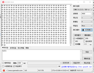

  • The picture above showed my code about UART communication.
    The PADC data is stored in ADC_BUFF_P,and transmitted by UART_TX_BUF. Each time the data has been transmitted by UART_TX_BUF, I use UART_LINE_STATUS register BIT4 to judge whether the data has been transmitted.
    When ADC_BUFF_P[1] and ADC_BUFF_P[0] have been transmitted, UART transmitt 0x00 to seperate the data as a tag.
    In 9600 baud rate, this work well. As shown in picture, the data structure is 0XAA 0XAA 0X00 0XAA 0XAA 0X00(here 0XAA means PADC_DATA), the transmitt go well.

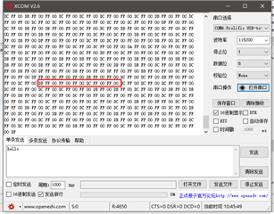

    In 115200, this data structure has been ruined. I don't know why, but it shows uart didn't work correctly in 115200 baud rate.
    Could you please share some scope captures of the UART transmissions and read from the UART_LINE_STATUS register? This will help determine what part of the communication is having trouble.
