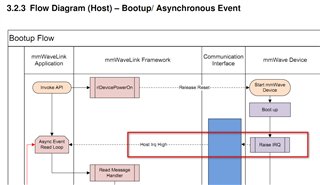

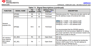

With SOP=7 (I2C mode of operation), does external host still need to check the pin P6 (SPI_HOST_INTR_1) of AWR2243 as the host interrupt function during I2C communication?
I checked the code of mmWaveLink_SingleChip_Example in DFP 2.2.3.1 and I found for SPI/I2C mode, the only difference is to use SPI or I2C for read/write operation.
Can we update AWR2243 datasheet and mmWave-Radar-Interface-Control.pdf in DFP package to provide more detail info of the I2C mode of operation? I can't find detail info of I2C mode.
