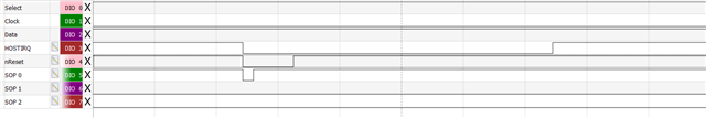

  • Thank you for the quick reply, I had already accounted for that typo. I followed your advice to create a volatile global counter. After executing my application it appears the global counter was not incremented meaning my rlsRegisterInterruptHandler is never called. What could be possible reasons for this?
    I should add that I am also observing the HOSTIRQ does indeed go high during execution of my application as shown here:
    **Update: I figured out some of my error handling was off, I have resolved the original problem of this thread.
