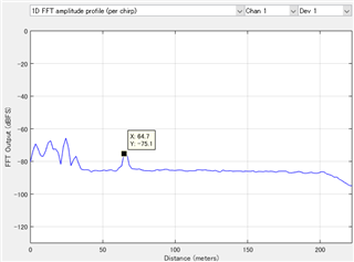

In the measurement result of mmwave stadio,
What is the reason why the measurement result is not clear like the user guide?
Measurement result

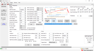

1. Poor chirp composition
2、Measurement environment
  The measurement environment is in a park with few things around.

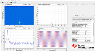

User guide picture
  • Hello Yousuke,
    The picture demonstrated in the user guide (which you have showed above) is for a "Test Source" object which is a simulated object at a programmed range (5m in this case).
    Your measurement scenario is a real life scenario with a few objects around. The reflections from the neighboring objects may not be strong enough to get a clear range peak. You can use a high RCS object or a strong corner reflector and keep it at a fixed distance w.r.t the sensor to observe and make sense of the captured data.
    Hope this makes sense.
