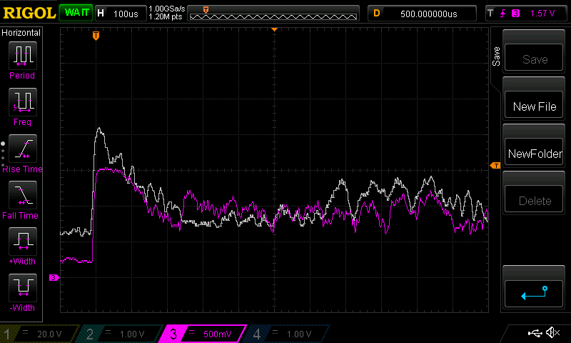

    Below are 2 examples of the signals I'm receiving. Both the pink and white traces are averaged over 8 samples to remove noise during development. The white trace is the first setup and the pink trace is the second. I found that I would get quite different signals when disconnecting and reconnecting the PZT even though everything is the same. The connections from the dev board and the PZT all seem fine. I'm coupling the PZT onto the container using super glue following the BOOSTXL-TUSS4470 user guide (though my super glue didn't have latex).
    Calculated TOF should be 85-105uS
    The TOF echo would likely be hidden here. On the white trace it looks like a bump at ~265us when there shouldn't be.
    Calculated TOF should be 340-325uS
    There is no TOF echo here, unless it's the little bump at 350us but it's so small that it would be hard to reliably detect in my opinion especially as the bump shape is similar to the previous capture's~265us bump.

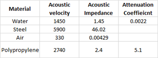

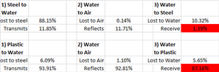

    I have received very good results using a plastic container but when moving to a steel one things get a lot worse. I've discovered that the impedance mismatch between water and plastic and water and steel are significant.
    Using the formulas in the Ultrasonic Sensing Basics report, with a signal going from steel to water, water reflecting from air and then water to steel again (not including the losses from the 2 super glue to steel transitions) I would get back 1.39% of my original signal whereas the same thing with a plastic container (with acoustic impedance of 2.4) and I would get back 87.16%. Bear in mind I'm using the direct drive configuration so I'm only outputting 20V pk-pk.

  • Hi Louis,
    Thanks for the detailed information here.
    I agree, there does not seem to exist a measurable echo in the scope shots. I also agree the small bump in the ~330us TOF is too small to measure in a  repeatable way, especially being that it is so similar to the ~100us TOF.
    The difference between steel and plastic make sense. The Ultrasonic Sensing Basics report gives a good reasoning for why may not be observing a return echo. Thank you for calculating the return signal strength for the plastic and the steel, I would consider this to be the primary cause for the difference.
    The most reasonable and effective way to improve the return echo would be via increasing the SPL of the transmit wave or increasing the sensitivity of the receiver. For a TUSS44x0 device we could use a transformer to excite the transducer with a higher voltage. Note, some transducers have max drive voltages too low for use with a transformer. It is recommended to consult the datasheet to help understand if the transducer is capable of use with a specific drive voltage and or burst count.
    Burst count can also increase to improve the SPL of the transmit wave, however you will lose short range sensing distance in a monostatic configuration.
    Finally, increasing the gain for the device can help with improving the relative strength of the echo. Assuming the device gain isn’t already maxed out for the LNA, you can increase the LNA gain and alter the log amp to improve the dynamic range of the receiver.

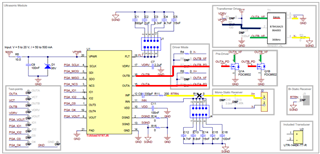

    I am trying to test out a transformer using the BOOSTXL-TUSS4470 (not the BOOSTXL-TUSS4440 which would be preferred because it's already setup but they are quite expensive). I've added a 300kHz transformer and transducer (200V pk-pk max). At this time I've removed the transducer signal from INP by removing R12 because I was concerned about the increased voltage seen at the INP pin.
    Looking at the PZT signal only it looks to be fairly good when using the boards pre-driver and setting the config setting. So I'm looking to start testing on an actual steel container ASAP. But first I want to ensure I take the required precautions. Could you also answer the questions below please?
    1. I'm assuming I need to calculate the max voltage at the TUSS4470 INP pin and adjust C9 and R11 accordingly?
    2. Also, I couldn't see anywhere which describes how to calculate mono-static receiver components C10 and R13. I'm assuming they are for dampening but not sure how to calculate their effectiveness unless it's trial and error?

    1. You are correct, I recommend verifying the INP pin is not being overdriven after the addition of the transformer. Values for C9(CINP) R11(RINP) can affect the voltage that appears at the RINP pin. The datasheet recommendations are usually optimized for general use, but it doesn’t hurt to verify everything is within specification, especially if the transformer is different compared to what was used in the EVM.
    2. The receiver components C10 and R13 can be very critical to transducer performance. Unfortunately, there is no easy way to obtain exact values without some amount of trial and error. Section 4.4 of SLAA732 details the process for tuning the capacitor and resistor in a monostatic transformer driven application, Link here: SLAA732. Note the document is catered to the PGA460 device, but the ideas regarding tuning will be similar among any ultrasonic AFE that uses a transformer. A rough range for tuning capacitors is usually from 100pF to 2000pF, and Rdamp from about 500ohm to 25kohm.

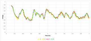

  • Hi Jacob,

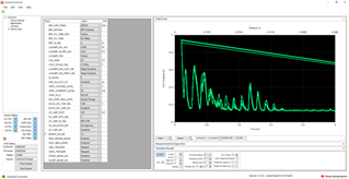

    I've got everything setup for the plastic container using the transformer approach. Below is the circuit I'm trialling on the BOOSTXL-TUSS4470 and the TUSS Generation III EVM GUI configuration I'm using. I've highlighted the connections being used.
    Xformer attempt
    The transformer is Epcos part B78416A2360A003 (300kHz 1:1:9) with secondary inductance of 3mH. The Transducer is Multicomp part MCUSD13A300B09RS (300kHz). C6 is fitted with a 100uF 35V al cap. Note that the BOOSTXL-TUSS4440 is fitted with a Coilcraft WA8351-AL which is very similar to the Epcos part in turns ratio and secondary inductance. VPWR was set from 7.5V to 10V for trials which gave around 157-183V which connected to a scope but I know that effects the PZT signal. Also note that I've not yet fitted C10 which I know will effect the resonance of the circuit from your guide here. I'll try this today but I'm not feeling too hopefully it'll change everything as much as needed.

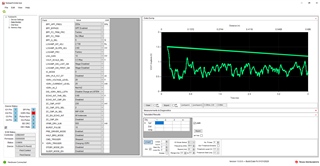

    Here are the results I'm getting from the TUSS Generation III EVM GUI which are terrible. I tried a whole variety of config settings to get as best a signal as I could but I'm open to suggestions.
    Plastic Container Data (HV 300kHz XFMR + PZT).xlsx
    In comparison, using the direct drive approach (no transformer) on a plastic container and a 1Mhz transducer yields incredibly good, clean results. I understand that the change in transducer frequency will change the peak shapes but the signal itself is very different. Note that the fluid heights are different so different TOF's will be expected.
    Plastic Container Data (1MHz Direct Drive + PZT).xlsx
    I was expecting it would look the same except for wider peaks but it's quite different. I'm looking get this to work and then I'll move to the steel container for trials.
    Is there anything that you can think of?
    Thank you, Louis
  • Hey Louis,
    I am sorry to see the results are so poor with the TF drive. In my opinion I do not see much of a return signal in the GUI, unless you expect the return at around .65ms
    Below are some of my initial recommendations to possibly improve the echo.
    You can use a BPF instead of the HPF. I do not think this is the reason for issue, but it could reduce any HF noise that may couple into the input.
    On the topic of noise reduction, you can also try to adjust CFLT. I am uncertain what value you are currently using, but I roughly calculated around 2.2 nF as a value for 300kHz drive frequency (this does not have to be an exact value).
    C10 will make a difference, but I am hesitant to say it will be the drastic change required for the desired improvements.
    It may be helpful to scope the transducer to verify the burst looks proper, and that the ring down of the transducer is sufficient for the application. If the ring down of the transducer is taking too long to decay, it is possible that the return echo amplitude will be affected.
    Hardware wise, the transformer and pre-driver look proper. The register settings do not appear to have any issues at a quick glance.
    One note in looking at your Excel results, the echo signal results look reasonably consistent even though they do not possess a prominent return echo like the direct drive. This makes me believe the waveform is representative of the sound waves, as noise would likely cause the results to look reasonably different between tests.
    I can consult with the team regarding any further suggestions they may have. Assuming the transducer was excited at the mentioned voltage level, I would expect to see a pretty clear echo relative to the noise of the system. This is a reason why I think verifying the burst signal may give some insight into what is occurring. You could also probe transformer inputs to verify the FETs are switching properly.

  • Hi Jacob,
    Thank you for your response. I added Cdamp as 3.9nF and found that it did fix the issue with the plastic container. I was then seeing good results. My setup was using 7V drive from the TUSS4470, 7.5V at VPWR.
    So I then moved back to the metal keg and was receiving bad results again. I changed CFLT to be effectively 1.68nF (by using C1 and C2) as suggested but this didn't change much. I also changed the VDRV and VPWR to 10V. I scoped the transducer lines and saw about 100V pk-pk. I did note that I didn't see more than this is when raising VPWR to to 15V. I'm wondering if the transformer isn't delivering enough drive current? Below is a screenshot of the steel container, note that the peaks should be around around ~300-350uS. You can see it's not great, there are 2 peaks which look good but I don't understand why they would be there and not before, I've certainly not got 0.7mS worth of water in the container!
    After scoping the PZT line, I'm quite sure the MOSFET's are triggering correctly because the transitions are sharp.
    Thank you,
    Louis
  • Hey Louis,
    Great to see the improvement of Cdamp, the plastic tank looks great.
    It is possible the transformer is limiting the current delivered to the transducer for the higher VPWR settings.
    It is interesting to see the prominent spikes with the keg appearing at unexpected points. Sometimes the geometry of the tank can affect the TOF response. For example, in some cases the tank walls can reflect the signal back at a different time than the calculated ideal TOF. An easy way to test this is to change the water level to different points, both higher and lower than the current setup. This will help us understand why the TOF looks the way it does, and possibly what is causing the TOF to be incorrect.
    Please let me know if this testing is possible, I am very interested to see if the results will correlate with changes in water level.
