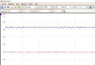

  • Hi Alec,
    I am aware of the characteristics necessary for the realization of a CAN bus. However, I still have to read a certain frame on the oscilloscope at the terminals of the CAN connector, even if it is an error.
    In addition I also performed measurements on the Tx / Rx of the U1 transceiver (TCAN1042HGVDQ1) where I should at least get some frame ... but nothing conclusive
    Left image: Rx and right image Tx on U1
    *My init Can_init() function called after MmwDemo_CLIInit(MMWDEMO_CLI_TASK_PRIORITY); in the void MmwDemo_initTask(UArg arg0, UArg arg1)
    *My  Can_Transmit () function is called after MmwDemo_transmitProcessedOutput(gMmwMCB.loggingUartHandle, result,
    &currSubFrameStats->outputStats); in MmwDemo_DPC_ObjectDetection_dpmTask:

    I get an errCode = -3502 in my transmit function at following lines:
    retVal = CANFD_transmitData (txMsgObjHandle, msg_id, CANFD_MCANFrameType_FD, len, &txmsg[index],&errCode);
    if (retVal <0)
    System_printf ("Error: CANFD TRANSMIT 1 %d \n",errCode);
    return ;
    Do you know what this means? Can this error be due to the fact that I have nothing connected to my CAN connector?
    How can I resolve it?

     *    Error code is defined as a negative interger. It comes from the following categories:
     *    - Drivers
     *    - Control modules
     *    - Data Processing Chain
     *    - Data Processing Unit
     *    - Demo
     *    The error code is defined as (Module  error code base - Module specific error code).\n
     *    The base error code for the above modules can be found in @ref mmwave_error.h\n
     *    The base error code for DPC and DPU can be found in @ref dp_error.h
     *    Module specific error code is specified in the module's header file.
     *    Examples:
     *       - UART driver error code is defined in uart.h
     *       - DPC error code is defined in the dpc used in demo (ti/datapath/dpc/objectdetection/objdethwa)
     *  @subsection mmwave_error mmWave module Error Code
     *    Error code from mmWave module is encoded in the following manner:
     *    Bits(31::16)  |  Bits(15::2)   | Bits (1::0)
     *    mmwave  error  | Subsystem error   | error level
     *    - mmwave error is defined in mmwave.h \n
     *    - Subsystem error is returned from sub-system such as mmwavelink and mailbox driver. \n
     *    - Error level is referred as WARNING leve and ERROR level.
     *    - mmWave exposes an API - MMWave_decodeError() that can be used in demo to decode error code
     *  @subsection mmwave_error_example Example
     *    - Here is an example on how to parse the error code - "-40111"\n
     *        -# The error code is from module with error base "-40000", which indicates it is DPC error.\n
     *        -# By referring to @ref dp_error.h, base "-40100" is from HWA based objectdetection DPC.\n
     *        -# Then find the error code in objectdetection.h for error(-11) as DPC_OBJECTDETECTION_ENOMEM__L3_RAM_RADAR_CUBE
     *    - Another example is with mmWave control module: - "mmWave Config failed [Error code: -3109 Subsystem: 71]"\n
     *        -# The above message indicates the error is from module(-3100 ->mmwave) with error -9(MMWAVE_ECHIRPCFG)\n
     *        -# The subsystem(mmwavelink) error is 71(RL_RET_CODE_CHIRP_TX_ENA_1INVAL_IN) which can be found in mmwavelink.h
     *************************** Include Files ********************************
    /* Standard Include Files. */
    #include <stdint.h>
    #include <stdlib.h>
    #include <stddef.h>
    #include <string.h>
    #include <stdio.h>
    #include <math.h>
    /* BIOS/XDC Include Files. */
    #include <xdc/std.h>
    #include <xdc/cfg/global.h>
    #include <xdc/runtime/IHeap.h>
    #include <xdc/runtime/System.h>
    #include <xdc/runtime/Error.h>
    #include <xdc/runtime/Memory.h>
    #include <ti/sysbios/BIOS.h>
    #include <ti/sysbios/knl/Task.h>
    #include <ti/sysbios/knl/Event.h>
    #include <ti/sysbios/knl/Semaphore.h>
    #include <ti/sysbios/knl/Clock.h>
    #include <ti/sysbios/heaps/HeapBuf.h>
    #include <ti/sysbios/heaps/HeapMem.h>
    #include <ti/sysbios/family/arm/v7a/Pmu.h>
    #include <ti/sysbios/family/arm/v7r/vim/Hwi.h>
    #include <ti/sysbios/utils/Load.h>
    /* mmWave SDK Include Files: */
    #include <ti/common/sys_common.h>
    #include <ti/common/mmwave_sdk_version.h>
    #include <ti/drivers/soc/soc.h>
    #include <ti/drivers/esm/esm.h>
    #include <ti/drivers/pinmux/pinmux.h>
    #include <ti/drivers/crc/crc.h>
    #include <ti/drivers/gpio/gpio.h>
    #include <ti/drivers/mailbox/mailbox.h>
    #include <ti/control/mmwave/mmwave.h>
    #include <ti/control/dpm/dpm.h>
    #include <ti/datapath/dpc/objectdetection/objdethwa/objectdetection.h>
    #include <ti/drivers/osal/DebugP.h>
    #include <ti/drivers/uart/UART.h>
    #include <ti/utils/cli/cli.h>
    #include <ti/utils/mathutils/mathutils.h>
    #include <ti/utils/cycleprofiler/cycle_profiler.h>
    #include <ti/demo/utils/mmwdemo_rfparser.h>
    #include <ti/demo/xwr64xx/mmw/mmw_output.h>
    /* Demo Include Files */
    #include <ti/demo/xwr64xx/mmw/mmw.h>
    #include <ti/demo/xwr64xx/mmw/data_path.h>
    #include <ti/demo/xwr64xx/mmw/mmw_config.h>
    #include <ti/demo/xwr64xx/mmw/mmw_res.h>
    #include <ti/board/antenna_geometry.h>
    #include <ti/demo/utils/mmwdemo_flash.h>
    /* CANFD Driver Include Files */
    #include <ti/drivers/canfd/canfd.h>
    #include <ti/drivers/pinmux/pinmux_xwr68xxAOP.h>
     * @brief Task Priority settings:
     * Mmwave task is at higher priority because of potential async messages from BSS
     * that need quick action in real-time.
     * CLI task must be at a lower priority than object detection
     * dpm task priority because the dynamic CLI command handling in the objection detection
     * dpm task assumes CLI task is held back during this processing. The alternative
     * is to use a semaphore between the two tasks.
    #define MMWDEMO_CLI_TASK_PRIORITY                 3
    #define MMWDEMO_DPC_OBJDET_DPM_TASK_PRIORITY      4
    #define MMWDEMO_MMWAVE_CTRL_TASK_PRIORITY         5
    #if (MMWDEMO_CLI_TASK_PRIORITY >= MMWDEMO_DPC_OBJDET_DPM_TASK_PRIORITY)
    #error CLI task priority must be < Object Detection DPM task priority
    #endif
    /* These address offsets are in bytes, when configure address offset in hardware,
       these values will be converted to number of 128bits
       Buffer at offset 0x0U is reserved by BSS, hence offset starts from 0x800
    #define MMW_DEMO_CQ_SIGIMG_ADDR_OFFSET          0x800U
    #define MMW_DEMO_CQ_RXSAT_ADDR_OFFSET           0x1000U
    /* CQ data is at 16 bytes alignment for mulitple chirps */
    #define MMW_DEMO_CQ_DATA_ALIGNMENT            16U
    /*! L3 RAM buffer for object detection DPC */
    uint8_t gMmwL3[SOC_L3RAM_SIZE];
    #pragma DATA_SECTION(gMmwL3, ".l3ram");
     /*! TCM RAM buffer for object detection DPC */
    #define MMWDEMO_OBJDET_TCM_SIZE (49U * 1024U)
    uint8_t gDPC_ObjDetTCM[MMWDEMO_OBJDET_TCM_SIZE];
    #pragma DATA_SECTION(gDPC_ObjDetTCM, ".DPC_objDetTcmbHeap");
     *************************** Global Definitions ***************************
     * @brief
     *  Global Variable for tracking information required by the mmw Demo
    MmwDemo_MCB    gMmwMCB;
     * @brief
     *  Global Variable for LDO BYPASS config, PLease consult your
     * board/EVM user guide before changing the values here
    rlRfLdoBypassCfg_t gRFLdoBypassCfg =
        .ldoBypassEnable   = 0, /* 1.0V RF supply 1 and 1.0V RF supply 2 */
        .supplyMonIrDrop   = 0, /* IR drop of 3% */
        .ioSupplyIndicator = 0, /* 3.3 V IO supply */
    /* Calibration Data Save/Restore defines */
    #define MMWDEMO_CALIB_FLASH_SIZE	              4096
    #define MMWDEMO_CALIB_STORE_MAGIC            (0x7CB28DF9U)
    MmwDemo_calibData gCalibDataStorage;
    #pragma DATA_ALIGN(gCalibDataStorage, 8);
    /*Variables for CANFD */
    volatile uint32_t gTxDoneFlag = 0, gRxDoneFlag = 0, gParityErrFlag = 0;
    volatile uint32_t gTxPkts = 0, gRxPkts = 0, gErrStatusInt = 0;
    volatile uint32_t iterationCount = 0U;
    uint32_t dataLength = 0U;
    uint32_t msgLstErrCnt = 0U;
    uint32_t gDisplayStats = 0;
    uint8_t rxData[64U];
    uint32_t txDataLength, rxDataLength;
    CANFD_MCANFrameType frameType = CANFD_MCANFrameType_FD;
    static void MCANAppInitParams(CANFD_MCANInitParams* mcanCfgParams);
    CANFD_Handle canHandle;
    CANFD_MsgObjHandle txMsgObjHandle;
    CANFD_MCANMsgObjCfgParams txMsgObjectParams;
     *************************** Extern Definitions ***************************
    extern void MmwDemo_CLIInit(uint8_t taskPriority);
     ************************* Millimeter Wave Demo Functions **********************
    void MmwDemo_mmWaveCtrlTask(UArg arg0, UArg arg1);
    void MmwDemo_dataPathInit(MmwDemo_DataPathObj *obj);
    int32_t MmwDemo_dataPathConfig(void);
    void MmwDemo_dataPathOpen(MmwDemo_DataPathObj *obj);
    void MmwDemo_dataPathStart (void);
    void MmwDemo_dataPathStop (MmwDemo_DataPathObj *obj);
    void MmwDemo_transmitProcessedOutput(UART_Handle uartHandle,
                                         DPC_ObjectDetection_ExecuteResult *result,
                                         MmwDemo_output_message_stats      *timingInfo);
    void MmwDemo_initTask(UArg arg0, UArg arg1);
    void MmwDemo_dataPathTask(UArg arg0, UArg arg1);
    int32_t MmwDemo_eventCallbackFxn(uint16_t msgId, uint16_t sbId, uint16_t sbLen, uint8_t *payload);
    /* external sleep function when in idle (used in .cfg file) */
    void MmwDemo_sleep(void);
    /* Calibration save/restore APIs */
    static int32_t MmwDemo_calibInit(void);
    static int32_t MmwDemo_calibSave(MmwDemo_calibDataHeader *ptrCalibDataHdr, MmwDemo_calibData  *ptrCalibrationData);
    static int32_t MmwDemo_calibRestore(MmwDemo_calibData  *calibrationData);
     *  @b Description
     *  @n
     *      Send assert information through CLI.
    void _MmwDemo_debugAssert(int32_t expression, const char *file, int32_t line)
        if (!expression) {
            CLI_write ("Exception: %s, line %d.\n", file, line);
    *************************** CAN Driver Initialize Function ***********************
    void Can_Initalize(void)
        System_printf ("CAN INITIALIZE \n");
        int32_t errCode = 0;
        int32_t retVal = 0;
        uint8_t instanceId=0;
        CANFD_MCANInitParams mcanCfgParams;
        CANFD_MCANBitTimingParams mcanBitTimingParams;
        CANFD_MCANMsgObjCfgParams rxMsgObjectParams;
        CANFD_MsgObjHandle rxMsgObjHandle;
        gTxDoneFlag = 0;
        gRxDoneFlag = 0;
        /* Setup the PINMUX to bring out the XWR16xx CAN pins */
        Pinmux_Set_OverrideCtrl(SOC_XWR68XXAOP_PIND1_PADAE, PINMUX_OUTEN_RETAIN_HW_CTRL,PINMUX_INPEN_RETAIN_HW_CTRL);
        Pinmux_Set_FuncSel(SOC_XWR68XXAOP_PIND1_PADAE, SOC_XWR68XXAOP_PIND1_PADAE_CANFD_TX);
        Pinmux_Set_OverrideCtrl(SOC_XWR68XXAOP_PINF2_PADAD, PINMUX_OUTEN_RETAIN_HW_CTRL,PINMUX_INPEN_RETAIN_HW_CTRL);
        Pinmux_Set_FuncSel(SOC_XWR68XXAOP_PINF2_PADAD, SOC_XWR68XXAOP_PINF2_PADAD_CANFD_RX);
        /* Configure the divide value for MCAN source clock */
        SOC_setPeripheralClock(gMmwMCB.socHandle, SOC_MODULE_MCAN, SOC_CLKSOURCE_VCLK, 4U, &errCode);
        /* Initialize peripheral memory */
        SOC_initPeripheralRam(gMmwMCB.socHandle, SOC_MODULE_MCAN, &errCode);
        MCANAppInitParams (&mcanCfgParams);
        /* Initialize the CANFD driver */
        canHandle = CANFD_init(instanceId,&mcanCfgParams, &errCode);
        if (canHandle == NULL)
            System_printf ("Error: CANFD Module Initialization failed [Error code %d]\n", errCode);
            return ;
        /* Configuring 1Mbps and 5Mbps as nominal and data bit-rate respectively
        Prop seg: 8
        Ph seg 1: 6
        Ph Seg2 : 5
        Sync jump: 1
        BRP(Baud rate Prescaler): 2
        Nominal Bit rate = (40)/(((8+6+5)+1)*BRP) = 1Mhz
        www.ti.com Initializing the Driver
        SPRACF7�April 2018 3
        Submit Documentation Feedback
        Copyright � 2018, Texas Instruments Incorporated
        Adding CAN-FD Tx and Rx to an Existing mmWave Project
        Timing Params for Data Bit rate:
        Prop seg: 2
        Ph seg 1: 2
        Ph Seg2 : 3
        Sync jump: 1
        BRP(Baud rate Prescaler): 1
        Nominal Bit rate = (40)/(((2+2+3)+1)*BRP) = 5Mhz
        mcanBitTimingParams.nomBrp = 0x2U;
        mcanBitTimingParams.nomPropSeg = 0x8U;
        mcanBitTimingParams.nomPseg1 = 0x6U;
        mcanBitTimingParams.nomPseg2 = 0x5U;
        mcanBitTimingParams.nomSjw = 0x1U;
        mcanBitTimingParams.dataBrp = 0x1U;
        mcanBitTimingParams.dataPropSeg = 0x2U;
        mcanBitTimingParams.dataPseg1 = 0x2U;
        mcanBitTimingParams.dataPseg2 = 0x3U;
        mcanBitTimingParams.dataSjw = 0x1U;
        /* Configure the CAN driver */
        retVal = CANFD_configBitTime (canHandle, &mcanBitTimingParams, &errCode);
        if (retVal < 0)
            System_printf ("Error: CANFD Module configure bit time failed [Error code %d]\n",errCode);
            return ;
        /* Setup the transmit message object */
        txMsgObjectParams.direction = CANFD_Direction_TX;
        txMsgObjectParams.msgIdType = CANFD_MCANXidType_29_BIT;
        txMsgObjectParams.msgIdentifier = 0xD1;
        txMsgObjHandle = CANFD_createMsgObject (canHandle, &txMsgObjectParams, &errCode);
        if (txMsgObjHandle == NULL)
            System_printf ("Error: CANFD create Tx message object failed [Error code %d]\n",errCode);
            return ;
        /* Setup the receive message object */
        rxMsgObjectParams.direction = CANFD_Direction_RX;
        rxMsgObjectParams.msgIdType = CANFD_MCANXidType_29_BIT;
        rxMsgObjectParams.msgIdentifier = 0xD1;
        rxMsgObjHandle = CANFD_createMsgObject (canHandle, &rxMsgObjectParams, &errCode);
        if (rxMsgObjHandle == NULL)
            System_printf ("Error: CANFD create Rx message object failed [Error code %d]\n",errCode);
            return ;
        System_printf ("CAN INITIALIZE DONE \n");
    ******************** CAN CALLBACK FUNCTIONS *****************
    static void MCANAppCallback(CANFD_MsgObjHandle handle, CANFD_Reason reason)
        int32_t errCode, retVal;
        uint32_t id;
        CANFD_MCANFrameType rxFrameType;
        CANFD_MCANXidType rxIdType;
        if (reason == CANFD_Reason_TX_COMPLETION)
                gTxPkts++;
                gTxDoneFlag = 1;
                return;
        if (reason == CANFD_Reason_RX)
                /* Reset the receive buffer */
                memset(&rxData, 0, sizeof (rxData));
                dataLength = 0;
                retVal = CANFD_getData (handle, &id, &rxFrameType, &rxIdType, &rxDataLength,&rxData[0], &errCode);
                if (retVal < 0)
                    System_printf ("Error: CAN receive data for iteration %d failed [Errorcode %d]\n", iterationCount, errCode);
                    return;
                if (rxFrameType != frameType)
                    System_printf ("Error: CAN received incorrect frame type Sent %d Received%d for iteration %d failed\n", frameType, rxFrameType, iterationCount);
                    return;
                /* Validate the data */
                gRxPkts++;
                gRxDoneFlag = 1;
                return;
                if (reason == CANFD_Reason_TX_CANCELED)
                        gTxPkts++;
                        gTxDoneFlag = 1;
                        gRxDoneFlag = 1;
                        return;
    static void MCANAppErrStatusCallback(CANFD_Handle handle, CANFD_Reason reason,CANFD_ErrStatusResp* errStatusResp)
        /*Record the error count */
        gErrStatusInt++;
        return;
    ******************** CAN Parameters initialize Function *****************
        /*Intialize MCAN Config Params*/
        memset (mcanCfgParams, sizeof (CANFD_MCANInitParams), 0);
        mcanCfgParams->fdMode = 0x1U;
        mcanCfgParams->brsEnable = 0x1U;
        mcanCfgParams->txpEnable = 0x0U;
        mcanCfgParams->efbi = 0x0U;
        mcanCfgParams->pxhddisable = 0x0U;
        mcanCfgParams->darEnable = 0x1U;
        mcanCfgParams->wkupReqEnable = 0x1U;
        mcanCfgParams->autoWkupEnable = 0x1U;
        mcanCfgParams->emulationEnable = 0x0U;

  • Daniel,
    Yes, the CAN transceiver relies on receiving its own signals back (since CAN resolves priority by monitoring whether the signal sent is overwritten by a higher priority message from another node) so typically if the bus is incomplete, the MCAN controller will keep retrying the first bit until it errors out.
    There are a couple ways that I believe you can resolve this. I believe you should able to connect CANH and CANL to each other with a 120Ohm terminating resistor and realize a complete but empty bus. Additionally, if you have any other devices laying around that support CAN, you can likely connect them to form a bus, as the CAN transceiver (For example our TCAN1042) will typically automatically act as a proper node on the bus without any software. Meaning, it will still pass along any other messages and complete the bus.
    Let me know if you have further questions.
    Alec
  • Hi Alec,
    Thank you for you reply.
    I have tested with a 120 Ohm resistor with an empty bus and still the same error -3502 and nothing on the scope.
    After some days I changed the power cable and have now a lower consumption (  +/- 0.53 A at 5V). I'm thinking that the cable had some problems.
    I have also  all rewired with an empty bus (120Ohm) and reset the MMWAVEICBOOST by the NRST button.
    After that I can now read the hardcoded message on the FDCAN with my scope.
    I have done the same experience but this time without the 120Ohm resistor. Directly by reading the FDCAN terminal.
    Still the same result on the scope :Successful. So the CANFD can transmit whitout any bus on the terminal.
    For all people who search to implement a CANFD and see this thread. The main.c code posted above is functional and send a hardcoded message!
    You must only pay attention to have a good power supply block.
    PS. Pay attention to send the config file by the mmwave visualizer to start the sensor!
