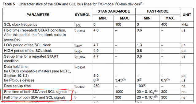

TMP75: I2C Interface Timing Consult
Part Number: TMP75
Hi Team,
Customer wants to consult with us about the Rise time/ Fall time of TMP75. I also attach the D/S screenshot below as your quick reference. There is no standard-mode in our TMP75 D/S. So customer is consulting whether they can simply follow the standard-mode time requirement in open I2C protocol? I also attach open I2C protocol below as your reference.
