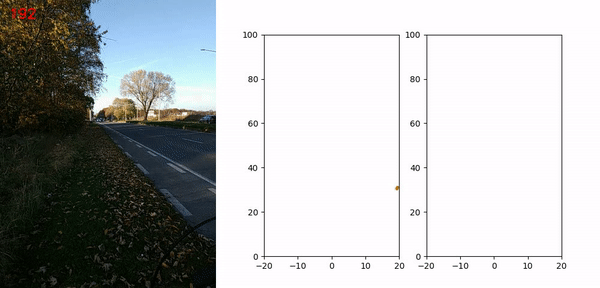

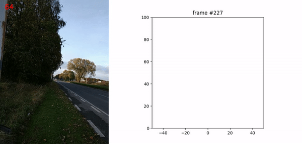

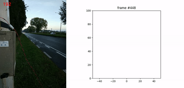

    I've done new measurements with the two radars detecting at the same time (6843 and 1843).
    Here are photos of the setup which is similar to the previous one (elevation, azimuth, config).
    The metal pole is at ~90° azimuth (from the boresight) for the two radars and shouldn't interfere.
    Here is a selected (X,Y) snapshot showing my issue : it seems that the 6843 (on the left) generates detection points which are more spread, specially on the X axis than the 1843 (on the right). In addition, the density of points at the correct spot seems better for the 1843.
    Finally, here is a short sequence :
    I understand there shouldn't be any difference by design but I would need to pinpoint the cause of this discrepancy (test setup, signal processing chain, PCB manufacturing, chip RF performances...) .
    Tell me if you need specific information on the setup.
    Massimo

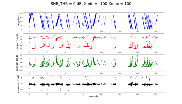

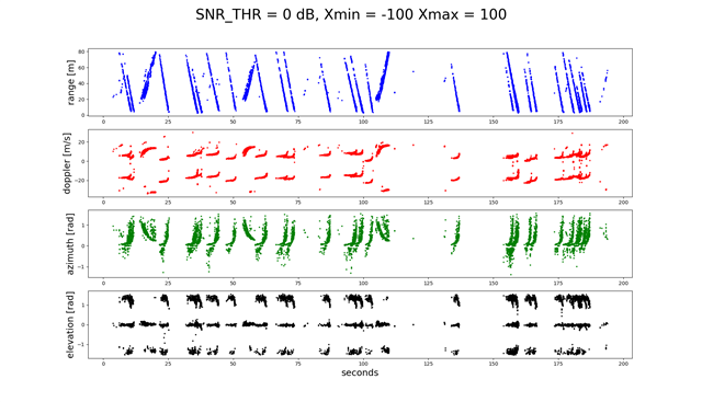

  • Hi Jackson,
    - I used the prebuilt binaries : traffic_monitoring_18xx_demo.bin and traffic_monitoring_68xx_demo.bin.
    I've also plotted the detection points for the two radars for the same traffic with respective default config files in a similar test setup as previously.
    The first one is the 1843 which seems OK.
    The second one is the 6843 and you can see that azimuth is noisier.
    The point density is noticeably lower than with the 1843.
    The elevation estimation has a real problem.
    And finally, disambiguating the speed seems problematic (there is a lot of aliasing).
    I didn't perform the calibration for any of the two radars and understand it can affect angle estimation and also speed disambiguation in noisy environments.
    Will the 6843 performances become similar to the 1843 with a proper calibration ?
    Would you point out anything else ?
    1843
    6843
    Calibration certainly can help the angle estimation, perhaps make it cleaner. For the aliasing, you may need to look at the range over consecutive frames to choose the correct velocity. Please try those and see if it helps. I am not sure why the performance might be different, although really it seems fairly close. I will consult with my team for more suggestions.
    Jackson
