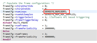

   Now we are using TI reference design, “TIDEP-0091_Power optimization for 77GHz-level transmitter reference design”, I want to know if the project 1443_level sensing demo can emit multiple chirps in one frame. Refer to the command configuration file, I try to change the number of numLoops to 8, but query the address data of radarCube(0x5100 0000), only the first chirp data is correct, the memory data corresponding to other chirps is very small, and since awr1443 is use HWA to process data, the data in the ADC buffer address(0x5200 0000)is always empty,only the HWA input buffer address contains adc data for one chirp.
    In view of the above problems, I want to configure a frame to emit multiple chirps based on the project of 1443_level sensing, and I know the other demo project is support this configuration. It is also advisable to attach the data address associated with the adc raw data, and the data address after 1D-FFT.
