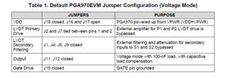

    J11 and J12 are related to the DAC output and should not affect the powering of the PGA970. Please make sure your other jumper settings are set to the default configuration:
    Please also make sure that power is being applied to VDD. You can probe directly at pin 20 of the PGA970.

    The jumper settings are set to default configuration. Power is also being applied to VDD. After going through the PGA970 datasheet, slds201a, I have enabled few features. Yet, the Avdd and Dvdd vales are not coming up to their voltages. Are there any extra configurations to be set on the GUI or USB2ANY explorer? It seems like the power at VDD is not being supplied to all the pins of PGA970.
