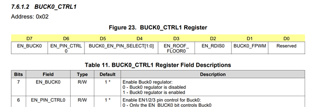

I am trying to use iwr6843aop to control the LP87524J PMIC on the EVM module through i2c. I wish to set the EN_BUCK0 bit in the BUCK0_CTRL1 register of PMIC to 0 to disable the BUCK0 output.
I do this by using the i2c driver in the mmwave sdk. Like the documentation of the PMIC menstioned, I send the register address 0x02 and register content 0x44 (which is the default configuration expect the EN_BUCKx bit is 0) through i2c to the pmic address 0x60.
the documentation about i2c master driver is shown below:
Register definition of PMIC
The message sending code is here:
My first question is that whether I am doing the right thing. Will this disable the output of BUCK0?

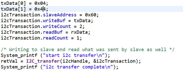

I do the exact same thing as my understanding of documenttion, and successfully build the project.
But I am running into a problem:
When I call the I2C_transfer function, it does not return:
code:
console
As you can see, the i2c transfer complete message is not printed in the console. I have checked that there is no break point stopping the program and the output of PMIC BUCK0 is not disabled.
I am wondering why it is not working.
