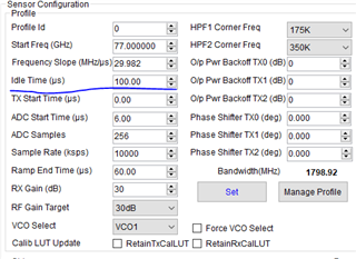

If one chirp total size/LVDS Speed =< Ramp time, that is, data collected in a chirp can be transmitted within the Ramp time. Can idle time be set to 0?
In addition, I saw the following content on page 95 of document:
However, some people in the forum say idle time cannot be 0, so I want to verify. Can idle time be set to 0? If not, what rules should be followed to minimize it.
Hello Kelong,
In the chirp idle time, the system firmware needs to prepare for the configuration of the next chirp as well, since every chirp can be different.
You can refer to the below application note to study the constraints on the idle time :
Programming Chirp Parameters in TI Radar Devices (Rev. A) (Section 5.1)
