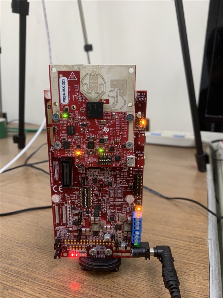

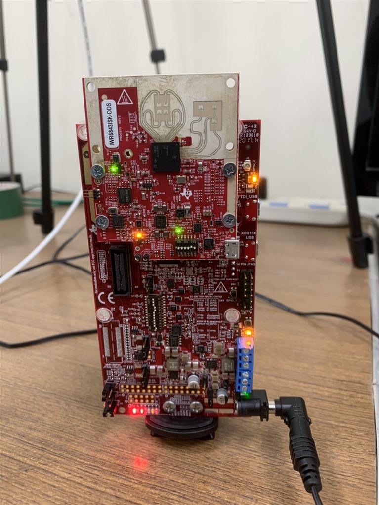

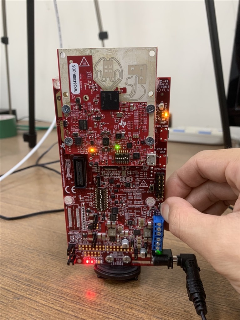

  • Hi, Chan
    Thanks for your replying.
    As you said,  "The DS2 LED should start in the off state on power up. When you press the reset button on the IC Boost Board it should briefly flash and then go back to the off state."
    Now, my problem is that my IC boost Board start in "on state" when power up,and after I pressed the reset button, the DS2 LED would not turned off.
    Besides,  I am using the same visualizer GUI as you do.
    here are the photos that I'm pressing the reset button with the EVM unplugged from the computer.
    1. power up with EVM unplugged from the computer
    2. pressing the reset button
    33. After that, DS2 LED still in the "on state"
