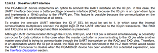

  • Hello Kailyn,
    Thank you for the register settings.
    It does not appear the customer has enabled the OWU interface for the PGA460 device. The setting is under the PULSE_P1 register, and involves writing a logical 1 to bit 7 of the register.
    Below is a table of the Pulse_P1 register allocation:
    Further information on OWU can be found in section 7.3.6.2.2 of the PGA460 datasheet:
    Please let me know if you have any questions.
    Thank you,
    Jacob
