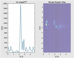

    In CCS debug mode, I test the code and it can run normally. As shown in following figure, the PC can receive the data from the board. And there is no error in CCS debug mode.

    I rebuild the project and download the .bin file to board using UniFlash. And the console of UniFlash shows "Program Load completed successfully". Then I change the SOP and reboot the board, but PC can't receive the data from the board. As shown in following figure, the PC received an Exception from User UART port.
    The following figure shows the line 2054 in dss_main.c
    The program can run correctly in CCS debug mode and PC can receive data from the board. But in deployment mode, the program cannot run normally. So, how to solve this problem?
