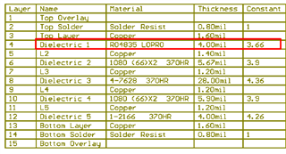

IWR6843: Antenna design issue
Part Number: IWR6843
IWR6843 on board antenna, as the eva-board has notch for RX ,TX, I followed its design, however, my PCB manufacturer could not assure the minmum gap 3.6mils, they only can achieve 4.2mils, can I increase the gap of Tx and Rx, or fill the node, somdbody can help repsonse me? thanks
