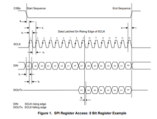

We hope communication with TI mode.
Is it can work on TI mode?
TDC7201 has fixed CPOL and CPHA :
CPOL =0
CPHA =0
An example communication frame is illustrated below.
Further information on communication can be found in section 7.5 of the TDC7201 Datasheet
Please let me know if you have any questions,
