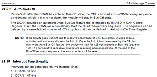

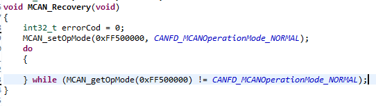

    My customer is testing CANFD bus off recovery time on 1642.
    In the test, they shorten Tx and Rx manually and after getting bus off interrupt, they called MCAN_Recovery to recovery CANFD to normal start. They found after this point, if they still keep Tx and Rx shortened, it takes about 700ms to get into the next bus off interrupt. They need to shorten this time to 200ms by Car OEM.
    May I know do we have an estimation about the CAN FD bus off recovery time?
