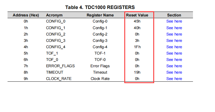

At present, both tri and start signals are available. At present, the first register of tdc1000 cannot be configured (the first one is successfully configured from 45 to 65), and the default initial value of the register is not written in the specification. Please see what's going on.
Default initial value of specification
  • Hello Kevin,
    Thanks for posting to the PS forum. Based on your image above the device is showing that you read 0x45 form CONFIG_0 and that is the correct reset value as shown in the datasheet. See image below:
    You mentioned you are able to reconfigure the register to 0x65. So I am just trying to figure out the problem the customer may be having. If you could please provide more info that would be helpful thank you!
