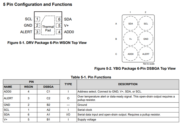

I have a TMP117 EVM and I want to connect it to two thermal sensors on flex PCB. I've broken off the tmp117 using the perforation, connected the USB and whats left of the evaluation board to a perforated circuit board, and to the circuit board I wired two identical 6 pin FPCs -- the only difference I made was in the connection. For one FPC, I jumped pins 4 and 5 together, and on the other I jumped pins 5 and 6. I currently have pin 1 unconnected, 2 to SCL, 3 to SDA, 4 to V+, and 6 to GND (with 5 being connected to V+ on one FPC, and GND on the other) [ see image if unclear-- bottom row of numbers is related to 0.5 mm side of the FPC]. When I connect the USB to the computer I get the following error: "Connected to USB2ANY Controller, but failed to connect to device TMP117 on I2C @0x48".
Any suggestions? I have tried connecting both FPCs directly to the evaluation board and got the same error message.

    Can you please clarify what the pins on the FPC are connected to the on the TMP117?  Can you please provide a schematic of your FPC?  Also, note that the TMP117EVM already includes 5.1k pull up resistors on SDA/SCL.
    The device address is defined by the address pin, which is pin 4 of the DRV package or pin C1 of he YBG package.
    Also, you can find a dual sensor version of the GUI below which can talk to two sensors on the same I2C bus with different addresses.
    https://dev.ti.com/gallery/view/THSApps/TMP117DualSensor_GUI/ver/1.1.0/

    As mentioned in the original post, I soldered a bit of metal to connect 4/5 on one FPC, and 5/6 on the other. I have the TMP117EVM with the DRV package, however that thermal sensor has been broken off in favor of a flex PCB with a thermal sensor which has the same configuration-- this is connected to the FPC using a standard connector for PCB:
    And to clarify, I have been using the dual sensor GUI that you linked. Please let me know if theres anything else I'm missing here. Thank you in advance for your help!
  • ... Turns out I got the error because the thermal sensors werent connected well, thank you though!
