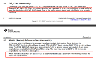

Hi supporter;
TI suggests use clock buffer when there are more than 2 cascade in swra574b.
what if we just use microstrip line or stripline and keep the equal length?
Is there any concern about drive capability or any other reason?
Hi supporter;
The drive strength level requirement is listed in the datasheet. For 2 chip cascade you dont need a buffer as the OSC_CLK_OUT from primary device can be fed to the only secondary device, however, for more than 2 cascade device(s) topology if you can maintain the spec requirement then it should be OK.
