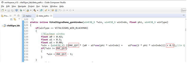

Hi, for IWR1443, in the project of vitalSigns_lab , in the file of data_path.c , Why Blackman window needs to be multiplied by ONE_Q17 ( #define ONE_Q17 (1U << 17) )

This multiplier is used because the Hardware Accelerator (HWA) requires the window coefficients to be stored as 18 bits. This format Q17 can be interpreted as Q1.17 i.e. using 1 bit for storing the integer part of the floating point number and 17 bits for the fractional part.
