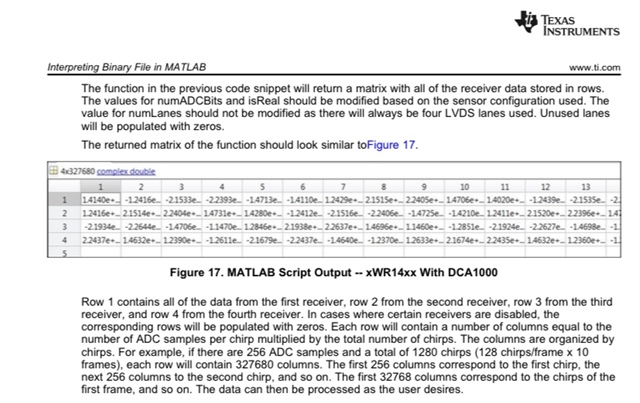

I followed the DCA1000 training video with the default setting. Then, I stepped to convert the captured data "adc_data.bin" to a matrix with all the receiver data stored in rows. But, I could not do it. Below are the log and other related files. May I know the reason behind not showing a matrix using the provided MATLAB code?

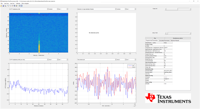

[22:12:26] [RadarAPI]: ar1.StartMatlabPostProc("C:\\ti\\mmwave_studio_02_01_01_00\\mmWaveStudio\\PostProc\\adc_data.bin")
[22:12:26] [RadarAPI]: No of files Captured: 1, Total no of frames for each device : 8
Generated plot after PostProc:
Generated data and csv files:
0334.InvalidConfigErr.csv7142.adc_data_Raw_LogFile.csv
Please suggest.
