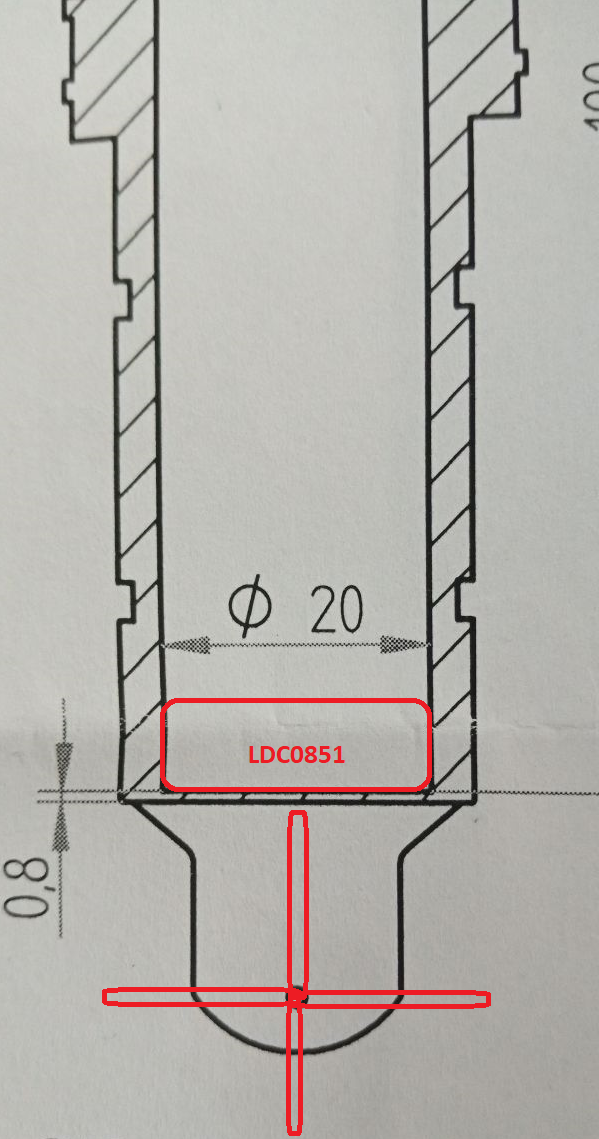

I want to use LDC0851 for event counting for paddle wheel systems.The paddle wheel have 5 teeth and rotating about 7000 rpm.
I use pvdf teeth with 316 stainless steel about 1mm diameter.
I try to design LDC0851  with  use spreadsheet ,as you see below picture.
Closest target distance approx. 1.5mm and i want to switch 2 mm~2.2mm and  spreadsheet design says Approx switch on and off difference  0.1mm.
Is it possible to sense 0.1mm difference with LDC0851? Or  i need to use LDC1101 or other LDC series.
    Sensing a 0.1mm difference is possible with the LDC0851, but the switching distance calculation is estimated based on a target that matches the size of the coil. As for your target, I have a couple clarifying questions.
    • The picture makes it seem like the stainless steel is a rod that goes back into the gear tooth. Is that correct?
    • Is the sensor pointed directly at the face of the stainless steel when at the closest distance or is there some angle offset?
    • What is the size of your gear? You mention a 1mm stainless steel target but size of the gear and the distance between teeth can make an impact on the sensing.

    1- Yes 1mm steel rod on gear tooth.
    2- Sensor not direclty face steel rod because 0.8 mm abs plastic have between steel rod and sensor.Closest distance 1.5 mm maximum(0.8 abs plastic + 0.7 air gap )
    3- Size of  gear 13 mm radius
    Attach picture of device dimensions.Totally have 5 teeth and each teeth dimensions 2 mm so i attach max 1.5 mm steel rod on teeth
    Thank you for the additional information. For the sensor coil design, you might want to consider a smaller coil to limit the impact of the gear spoke that is not directly in front of the sensor. Having something closer to a 4 or 5mm coil diameter will crease the coupling for the nearby spokes and will allow for the target to be a bigger portion of the sensor coil. See https://e2e.ti.com/blogs_/b/analogwire/posts/inductive-sensing-target-size-matters for more information on how target size impacts sensor performance.
