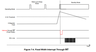

  • Hello Nirmith,
    It sounds like you are using the best option for your application at the moment. Another option you can do is have TMAG5273 set up to generate an interrupt INT pin when the threshold has crossed a specific value. This will generate the square wave that is typically used to obtain the electrical frequency. Look at section 7.3.3 in the datasheet for more information on how the interrupt functions works. The formula would change slightly since you would be getting twice the amount of transitions since it would function as a switch.
    Isaac
  • Hi Isaac
    Can you give me a more specific explanation on this quote "TMAG5273 set up to generate an interrupt INT pin when the threshold has crossed a specific value". And can you share me with code so that it can interface with microcontroller with I2C and the formula for it.
    Nirmith
  • Hey Nirmith,
    When INT_MODE is set on the TMAG5273, it can be setup to create an interrupt either on the SCL pin or through the INT pin. I find it easier to interrupt through the INT pin but this also depends on how many GPIO's you have available on your MCU.
    The interrupt occurs when the magnetic field goes above your programmed threshold, this is what I mean by a specific value. The threshold value is chosen by you and is configured using the X_THR_CONFIG, Y_THR_CONFIG, or Z_THR_CONFIG registers. The direction you choose mainly depends on where you are sensing the rotors polarity transitions. Essentially, you would be setting up TMAG5273 to act as a switch.
    If you choose to go through the interrupt function, then it might not be completely necessary to read the magnetic data for that channel since you should be seeing the INT pin toggling when the motor is running. The INT pin would be connected to a microcontrollers GPIO pin where you can use a timer to time the frequency of the falling edges of the input (falling edges since this is an active low pin).
    I made a mistake earlier and the calculation for RPM would remain the same, RPM= (60*Electrical frequency)/pole pairs. Since we are only timing the edges it would not make a difference to the formula. This would all be done inside the MCU. Just keep in mind that you still have to pay attention to the conversion time and we recommend that the conversion time is more than 2 times the max RPM you are expecting from the motor.
