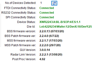

Even though both boards are set to the same switch settings and the same firmware, only the Rev. B board cannot be externally synchronized.

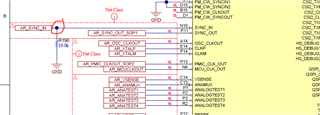

In the documentation spruit8d.pdf I noticed that for Rev.B the SYNC_IN signal connection to the J6 connector but I don't know which pin is connected to the SYNC_IN signal.
I would appreciate if you could tell me.

  • Hi Masuno-san,
    The pin will be N10. You can also find this information in the design zip files of AWR2243 in the schematic pdf.
    Pradipta.

    I understand that the SYNC_IN signal is coming from N10. Thank you very much. But I just want to know how to put an external trigger into this, the easy way.
    On the Rev. A board, there is a connection to SYNC_IN at pin 9 of the BP/LP connector (J5) and I connected the external trigger via cable and it worked.
    On Rev. B it did not work, and on p. 25 of the Spruit8d.pdf, the Design Revision History for Rev.B says "Enabled, by default, the SYNC_IN signal connection to the J6 connector". I can't figure out which pin of the J6 connector it is.

    It looks like there is an error in the users guide. The only change to RevB was capacitor C56 was updated from 220nF to 47nF.
    https://www.ti.com/tool/AWR2243BOOST#design-files
    The use of SYNC_IN pin should be identical on both RevA and RevB. Does the RevB board work as expected otherwise? Can you probe on resistor R196 and confirm if you can see the trigger at this point to make sure the trigger is reaching the device?

    Indeed I checked the trigger then I found that the trigger pulse voltage is too low, we only have 1V peek to peek, so it sometimes worked by chance.
