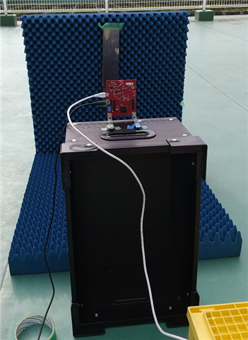

  • As a procedure, the two objects used this time are aluminum plates of 30 x 6 cm^2.
    When I measured it once with an aluminum plate, it was detected with a deviation of 1.79 to 3.58 deg. (perpendicular to the millimeter-wave radar antenna plane)
    (Figure 1)

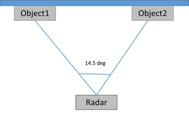

    Next, when I measured two aluminum plates with an interval of 14.5 deg, the result was 18.1 deg. When I saw it, I thought that the angle accuracy was out.
    (Figure 2)
    The figures is shown below.
    Figure 1
    Figure 2

    In your Figure (2), is the angle between the two objects with respect to the sensor 14.5 degrees or is it the DOA with respect to the Centre of the radar's field of view? If it's the latter, are you seeing this offset in both measures?
    I personally think of it as the angle between two objects relative to the sensor.
    (Shown the figure.)

  • Hi Hiroyuki-san,
    Thank you for sharing your inputs. in fig 2 csv, it appears that there is only one object in the scene.
    Regardless, the issue you were initially observing could arise if the RX channel phase offset has not been compensated before the calculation of AoA. Therefore, I request you to perform the same by referring to the section Range Bias and Rx Channel Gain/Offset Measurement and Compensation in the mmwave SDK user guide. Please let me know if the issue persists after the same has been done.
