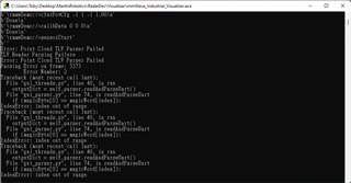

However, all the generated configs, even including the default configs, can not work on the out-of-box demo.
I am using the mmWave_Industrial_Visualizer to send the config and display the results, the program console shows the following error:
I have checked this in more detail, and I believe this error is because the radar is not sending any data.
On the other hand, if I try some configs provided by the labs (e.g., the area scanner lab), the OOBdemo can work just fine, which convinced me that the config files generated by the mmWaveSensingEstimator have some issues.
Please tell me what is the issue and how could I fix it.

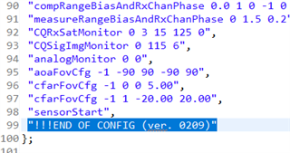

  • After some trials, I found that if I add a dummy command "!!!END OF CONFIG" at the end of the file, it will work.
    (as shown in the following file)

    !!!END OF CONFIG
    This should be the issue of the out-of-the-box demo (or even for other demos), but I haven't looked into it in detail.

  • Hi Po-Chih Chen,
    Thanks for finding this! If there is not a "new line" character at the end of a configuration file it will cause an error when you try to use this, so this root cause makes sense! We will fix this soon.
    Thanks again,
    Angie
  • I think newline is not the issue though.
    I am using the hard-coded config demo, which has this issue, too.
    I still need this additional line to get it working.
  • Hi Toby,
    This comment should act as a new line, but yes some comment or new line is needed for the configuration to be usable.
    Angie
