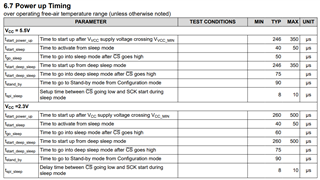

Question 1. How much power does the TMAG5170 device use when transitioning from one operating mode to another?
For example,
-> transitioning from Configuration mode to Active Conversion mode takes approximately 125uS
-> does the device use Configuration mode levels of power during this 125uS?
-> does the device use Active Conversion mode levels of power during this 125uS?
Question 2: Also, does it take another 125uS for the chip to transition from Active mode to configuration mode? Or how long does it take to transition from Active mode to one of the other modes?

    1. This isn't within the datasheet, so I don't have a reference on hand.  I will try to go and measure with a current probe or power monitor and get back to you on this by Monday.
    2. Transition times are shown in section 6.7 and figure 7-4:
      Approximate time to initiate a conversion is in table 7-3:
      I don't see a specified number for the transition from Active measure to configuration mode.  I would expect it to be the same or faster.  In configuration mode, the device is not running the high speed oscillator.  I will try to capture this transition when I measure current during the transition.
    3. The device registers can be set during configuration mode and active mode.  In sleep mode, initiating SPI will wake the device.

  • Chad,
    I attempted a test of a single unit on an EVM with power supplied from an external source at 3.3V.  I connected a current probe about my Vcc wire and set a trigger on my CS pin. For this particular device,  I it took about 10 us from CS returning high at the end of the SPI write until current was stabilized when switching from Active mode to Configuration mode.  Running from Configuration mode to Active mode required about 130 us for the current to stabilize at the Active mode nominal value.

    How much current does the TMAG draw during the transition period?
  • Or how would I estimate the current draw? For example, would I use a trapezoidal approximation of current draw from Active Mode -> Configuration Mode?
  • It wasn't a gradual increase which you might estimate using a trapezoidal response.  During the transition, the current remained constant through most of the delay and then quickly steps to the final current, with only a slight rounding off as it reached the final value.
    Scott
  • thank you
  • So for clarity, I can project the current consumption during the transition as being the current used before the transition?
    so for example, for configuration -> active mode, the current consumed during the transition time is approximately the same as the current consumed during configuration mode normally.
                              for active -> configuration mode, the current consumed during the transition time is approximately the same as the current normally consumed during active mode.
  • Yes.  The measured current remained constant for me for the duration of the state change delay, and then steps quickly to the final current.  So switching from config mode to active mode, the current holds at the config mode level.  When changing from active mode to config mode, the current will holds at the active mode level.
