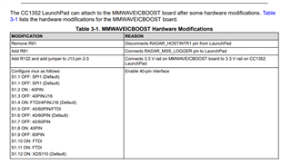

I have mmWaveBOOST, IWR6843AOPEVM and USB-TTL.
https://www.ti.com/tool/MMWAVEICBOOST
https://www.ti.com/tool/IWR6843AOPEVM
I want to mmWave sensor data print on Serial print on USB-TTL
But not received any data on UEB-TTL
Flow :- mmWaveICSensor(IWR6843AOPEVM) -> mmWaveICBOOST -> USB-TTL -> PC
mmICWaveSensor:-
 1)Firmware reference:- TIDA-010022(IWR6843) predefine binary file
 2)DIP switch configuration:-
  SW1.1 OFF
  SW1.2 ON
  SW1.3 OFF
  SW1.4 OFF
  SW2.1 OFF
  SW2.2 ON
  SW2.3 ON
  SW2.4 OFF
mmWaveBOOST:-
 1)DIP switch configuration:-
  SW1.1 OFF
  SW1.2 ON
  SW1.3 ON
  SW1.4 OFF
  SW1.5 ON
  SW1.6 ON
  SW1.7 ON
  SW1.8 OFF
  SW1.9 OFF
  SW1.10 ON
  SW1.11 ON
  SW1.12 ON
 2)Rx and Tx pin for UART communication:-
  Rx:- J5.5
  Tx:- J5.7
  baud Rate:- 115200/921600
USB-TTL-
  Rx:- J5.5
  Tx:- J5.7
TIDA-010022:-
https://www.ti.com/tool/TIDA-010022
In this case mmWavesensor read data and pass on the CC1352 on UART protocol. I just need what data received on UART.
