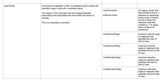

    The figure there shows the gain obtained by the antenna over the 2D plane in sight. The signal strength at the farther angles drops making it difficult to estimate the angle accurately, if at all. The field of view, in a sense, is the range of angles across which a strong signal can be obtained. Following the same, when an angle FFT is performed, only angles over a preset field of view range (say -60 to +60 degrees) are chosen and the rest are dropped. This is what one can interpret from the figure.
    Typically, the AWR1443BOOST has an azimuth FoV of ±60 degrees and elevation FoV of ±15 degrees.

  • Hi Robert,
    The objects are not dropped based on gain but rather on the FFT bin to angle mapping. The same can be observed in the Visualizer.
    You can follow the cfg below in the SDK to see how it is done.
