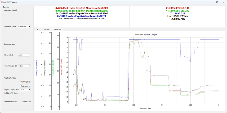

Channel Live Window (see Fig. 3-15 user guide): The colour coding of the ADC codes seems not to fit the Z and W values. Is channel 2 now blue or black of the ADC register codes?
How can it be that if the ADC codes for channel 2 (wheter it is blue or black) is at maximum with varying light and Z value is still rising? I do understand that channel 2 equals Z.
How is it possible that you can select a Gain of 7 or 8 in the GUI wheras the device only supports 6 levels. More interestingly: IT WORKS!! A miracle!

  • I have a blue 470nm LED.
    Issue 1:
    You see the codes value of 0x2708000 (equals 40927232 dec) on top in blue color. Because this is the highest value this should be the blue channel which is 2 (=Z) according to the data sheeet. But in the graph the blue coded y axes is denoted as channel 3, but it should be channel 2! It seems that in the graph channel 2 and 3 are mixed up. They have the right values but the wrong labeling channel wise.
    Issue 3:
    Above I have selected "Mode Select" Range 8. The data sheet specifies a gain range of 0 to 6. The GUI allows 0 to 8! And it works!
    Issue 2:
    Blue channel is 0x3ffffc0 which is maximum. Z value is around 11622.
    Now  I habe increased the LED intensity:
    Below the Blue channel codes is still at maximum (0x3ffffc0), but Z value is now around 28212 (more than double). How is that possible if channel 2 (the blue one) is equal to Z according to the data sheet.
  • Christian,
    it seems that channel 2 and 3 are correct on values (right side) however it is flipped in position on the codes (left side). Please interpret the black line as channel 3 and the blue line as channel 2 on the codes side (right side). We will fix this in the GUI.
    Regarding the mode select, the maximum gain range should in fact be 6 per datasheet spec. The range values of 7 and 8 are not interpreted as valid, but most likely have the gain set to 6 in the software program. We will fix this in the GUI as well.

    In regards to issue 2. As you mentioned channel 2 and channel 3 are in fact mixed up.
    Jalen
  • Dear Jalen,
    sorry, concerning issue 2 I believe I have not expressed myself correctly. What I meant is that the blue channel (which is in fact channel 2 of the IC) seems not to equal Z of the CIE colour space, as the datasheet suggests. It looks like that the GUI combines several channels for calculating Z of the colour space. This is independent from the mixed up channels 2 and 3 in the GUI.
    kr,
    Christian
  • Christian,
    The GUI performs the same light and color measurements as described in section 8.3.4.5 of the Datasheet.
    Jalen
  • Well that means that channel 2 does not equate Z of CIE as the datasheet might suggest.
    Does the GUI use the conversion matrix of equation 16 of chapter 9.2.4 or a different one?
    Thanks a lot,
    Christian
  • Christian,
    Yes, the conversion matrix of equation 16 is being used in the GUI.
    Jalen
