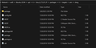

  • Dear John,
    Thank you for your response. The problem with this solution is that there is no R4F target inside the ti/target/arm/clang folder, there is only an M33F target. As you can see in the screenshot
    The only instance of R4F is in the ti/target/arm/elf folder and that is where I tried to reconfigure the target as I explained in my original question.
    I tried to create an R4F target inside ti/target/arm/clang by adding 3 files R4F.h , R4F.xdc and R4F.xs  like so:

    I've created these files based on M33F.h M33F.xs and M33F.xdc.
    This resulted in an error :
    js: "./config.bld", line 11: Error: Can't find the target named 'ti.targets.arm.clang.R4F' along the path '/opt/ti/bios_6_73_01_01/packages;/opt/ti/mmwave_sdk_03_04_00_03/packages;/opt/ti/xdctools_3_50_08_24_core/packages;..;': please check the spelling of the target's name and that it exists along this path.
    making package.mak (because of package.bld) ...
    gmake: *** No rule to make target `.configuro'.  Stop.
    It seems that my new files aren't recognized.
    Is there a better way of adding a target?
