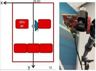

I tried the prebuild binary of CPD demo at C:\ti\radar_toolbox_1_30_00_05\source\ti\examples\InCabin_Sensing\AWR6843_CPD_with_Classification\prebuilt_binaries on AWR6843AOPEVM.
I tried below sensorPosition and it works ok.
sensorPosition 0 1.2 1.1 90 -90 0
Then I rotated the sensor with 180 degree again and set as sensorPosition 0 1.2 1.1 90 90 0. It can't work well.
Sensor setup is as below.
Below is recorded with only one person moving in 2nd row. You can also see moving object in 1st row also with same moving direction. It is abnormal.
Would you pls help to try and fix this?
Chris

    Can you give us a diagram or drawing indicating how the sensor is facing and positioned relative to the car seats in both scenarios? Are there any obstacles in your setup that could be giving reflections?
    Tim
  • Tim,
    Working setup with sensorPosition 0 1.2 1.1 90 -90 0 (page 12 of radar_toolbox_1_30_00_05\source\ti\examples\InCabin_Sensing\AWR6843_CPD_with_Classification\docs\AWR6843_CPD_with_Classification_Setup_Guide.pdf).
    Non-working setup with sensorPosition 0 1.2 1.1 90 90 0.

  • Hi, Chris:
    Did you have any mounting angle that works normal?  Which configuration file you are modify from?
    Please keep in mind that too much movement can result in multi-path reflection.  Please try with minimum movement.
    Zigang
  • HI, Chris:
    Can you modify the following function as below inside AWR6843_CPD_w_Classification_visualizer.m?   I have also attached the .exe file here.
    https://e2e.ti.com/cfs-file/__key/communityserver-discussions-components-files/1023/AWR6843_5F00_CPD_5F00_w_5F00_Classification_5F00_visualizer.exe

  • Zhigang,
    Thanks for your help. I finetune the parameter based on my sensor setup and it looks better.
    Chris
