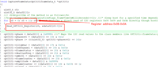

           I have realized automatic loading of calibration parameters stored in external EEPROM in OPT3101 SDK, and can correctly measure distance. I want to use C language to write opt3101 driver to realize automatic loading of calibration parameters in external EEPROM and correct measurement of distance. The picture on the right of my long transmission shows all the register addresses and parameters of OPT3101 read in SDK, and the picture on the left shows all the register addresses and parameters of OPT3101 read in my own program. Except for the read-only register, the rest register data are completely consistent, but the program I wrote myself has a large error in measuring the distance. If my program is missing those steps in reading distance data,    PS :  I'm using the same hardware to compare register data;
          This is my code for reading distance data:
           This is the parameter to my contrast register:

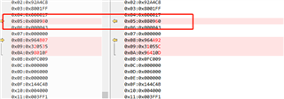

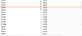

          Reg1.txt is the register address and value read in C code, Reg2.txt is the register address and value read in OPT3101 SDK;

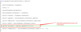

        I read the 0x08 0x09 0x0A registers, calculate the distance using the 0x08 register low 16 bits, and the calculation formula is simplified:
       Thanks!!!!
  • Pengsheng,
    Your calculation for distance doesn't make sense. The number becomes quite large then when you shift >>16 you will end up with a rounding error.
    You may want to work on the calculation formula. I don't have a C version, but I will look into it.

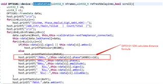

         The calculation formula I used is referred to the program in OPT3101 SDK, and the phase value is signed 32-bit, so there will be no overflow when multiplied by 14989. The image is the code for calculating distance in the OPT3101 SDK
        The floating point type is not used in the distance calculation. According to the calculation formula of the picture, multiply by 14989 and then shift 16 bits to the right

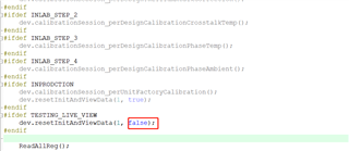

  • Gordon:
        I'm sure calculted in C code is Correct, I debug and check the phase value, and the result calculated manually according to the calculation formula is consistent with the calculation result of MCU;
       phase = 7895;
       (7895*14989) / 65535 = 1805.69
       Let me describe the case of two different values again:
       1、I use the same hardware
       2、The hardware has completed all the calibration steps and the calibration parameters are stored in the external EEPROM
       3、I turned off all conditional compilation in the OPT3101 SDK and only opened the TESTING_LIVE_VIEW macro definition
        The result is that the distance tested by me in the SDK code is correct, but there is an error in the distance measured in the C code, which is about 1860mm in the SDK and about 1800mm in the C code;
        Thanks!!!!

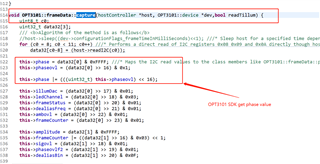

         This is  calculations for distance.
    typedef struct
    	int32_t  phase;
    	int32_t  amplitude;
    	uint16_t temperature;
    	uint16_t ambient;
    	uint8_t  channel;
    	int32_t  distance;
    }Opt3101Data_t;
    typedef struct
    	uint32_t phase; ///< phase value measured by the AFE. Actually 16 bit unsigned value upscaled to 17 bits with 1 bit of frameData::phaseovl flag added to the MSB. Same as OPT3101::registers::phase_out
    	bool phaseovl; ///< phase overload flag, specifying if phase value detected exceeds 16 bits. (greater than 65535). OPT3101::registers::.phase_overflow
    	bool phaseovlf2; ///< phase overload flag for frequency 2, specifying if phase value detected exceeds 16 bits. (greater than 65535). Same as OPT3101::registers::phase_overflow_f2

    void CaptureFrameData(Opt3101frameData_t *opt3101)
    	uint8_t c0;
    	uint32_t data32[3];
    	/// <b>Algorithm of the method is as follows</b>
    	//host->sleep((dev->configurationFlags_frameTimeInMilliSeconds)<<1); ///* Sleep host for a specified time depending on device configuration to OPT3101 AFE can update measurements to the registers.
    	for (c0 = 8; c0 < 11; c0++) ///* Performs a direct read of I2C registers 0x08 0x09 and 0x0A directly though hostController::readI2C method
    	  Read_OPT3101_Register(c0, &data32[c0-8]);
    	opt3101->phase = data32[0] & 0xFFFF; ///* Maps the I2C read values to the class members like OPT3101::frameData::phase, OPT3101::frameData::amplitude etc
    	opt3101->phaseovl = (data32[0] >> 16) & 0x1;
    	opt3101->phase |= (((uint32_t) opt3101->phaseovl) << 16);
    	opt3101->illumDac = (data32[0] >> 17) & 0x01;
    	opt3101->ledChannel = (data32[0] >> 18) & 0x03;
    	opt3101->frameStatus = (data32[0] >> 20) & 0x01;
    	opt3101->dealiasFreq = (data32[0] >> 21) & 0x01;
    	opt3101->ambovl = (data32[0] >> 22) & 0x01;
    	opt3101->frameCounter = (data32[0] >> 23) & 0x01;
    	opt3101->amplitude = data32[1] & 0xFFFF;
    	opt3101->frameCounter |= ((data32[1] >> 16) & 0x03) << 1;
    	opt3101->sigovl = (data32[1] >> 18) & 0x01;
    	opt3101->phaseovlf2 = (data32[1] >> 19) & 0x01;
    	opt3101->dealiasBin = (data32[1] >> 20) & 0x0F;
    	opt3101->frameCounter |= (data32[2] & 0x03) << 3;
    	opt3101->ambient = (data32[2] >> 2) & 0x3FF;
    	opt3101->temp = (data32[2] >> 12) & 0xFFF;
    	opt3101->tmain = opt3101->temp;
    static Opt3101frameData_t Data[3];
    void ReadOpt3101Data(Opt3101Data_t *opt3101)
    	Opt3101frameData_t framedata;
        uint8_t i;
    	CaptureFrameData(&framedata);
    	Data[framedata.ledChannel] = framedata;
    	opt3101->channel = framedata.ledChannel;
    	opt3101->ambient = Data[framedata.ledChannel].ambient;
    	opt3101->amplitude = Data[framedata.ledChannel].amplitude;
    	opt3101->phase = Data[framedata.ledChannel].phase;
    	opt3101->distance = (opt3101->phase*14989)>>16;
    	opt3101->temperature = (Data[framedata.ledChannel].tmain >> 3) - 256;
        Thanks!

  • Gordon:
        Please look at the program code carefully, I read the register data from the address 0x08-0x0A, I consult the data manual, there is no 0x06 address register, I ask you have an external EEPROM OPT3101 demo board, my test condition is to automatically load the stored external EEPROM calibration data and then read the data;
          Thanks!!!

        I'm comparing SDK and my own C code to read all the registers, repeated reading, except for the relevant registers about distance measurement, the data of 0x05 register is inconsistent, the SDK code reads the data of 0x05 register, check the data manual, the 0-21bit of this register should be fixed, but the data I read will change. Yes 0x05 register data manual Is there a problem?
          This is me reading register 0x05 data:
        Does the 0x05 register have any other functions?
        Thanks!!

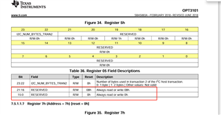

  • Pengsheng,
      The only usable data in 05h is "23:22 I2C_NUM_BYTES_TRAN2" The other bits are for internal use only and will not be consistent, or usable by the customer. Reading these bits will only cause confusion. Internally most reserved registers may have more than one function and output factory data for multiple conditions. TI will not support internal functions externally or for customer use.
  • Gordon:
          The same hardware, after automatically loading parameters, SDK and C code read the value of the 0x05 register inconsistent is normal? Now I print out serial port many times, except for registers related to ranging 0x08.0x09.0x0A.0x3B.0x3C, and 0x05, the two codes read the value are the same, now there is a difference between the two codes ranging, through the other bits of register 0x05 can see what is the reason?Can you tell me what bit15-0 in register 0x05 means;
          Thanks!!!!
  • Hi Pengsheng,
    The bits in register 0x05 will not be consistent, as Gordon has mentioned. These bits are used for internal information only and should be ignored.
    Nicole
