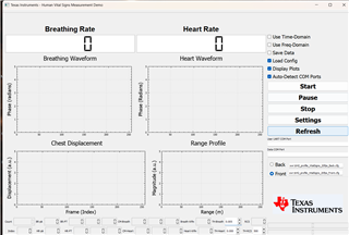

    We are currently using the AWR6843 radar sensor for monitoring the vital signs(mmwave_industrial_toolbox_4_9_0\labs\vital_signs\68xx_vital_signs\gui\gui_exe) of a driver within a vehicle. Our setup includes the mmWave BOOST board and the AWR6843 radar sensor, positioned at the back of the driver , according to the guidelines provided in the user manual.
    Actually whenever the runs completes and it generates the Bin file. After that if i want to take the data again of a driver i press the rest button that is shown in the figure below
    Now if i don't press this reset button and again run the system for file saving data then it shows this error. Shown below
    So basically i want that i don't have to reset the device again for different driver, if I run the GUI it should run properly without resetting the device.
    This is likely not possible and you will have to keep them different files and reset the device.

    Problem 2: How can we make the "save data" & "Back" configuration as the default, so that if i run the SDK i just have to click on "Start".

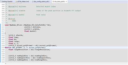

    Problem 3: Now we are able to edit the file (mss.c, dss.c) , so can you please direct me how and at where is the line of code for file saving, so that i can add the time stamp and then it save the file.
    below i am attaching the file we are trying to editing vital_signs.zip

    The file saving should happen in the Python GUI, not in the SDK. You would have to edit the GUI to be able to save the files differently.
    Tim
