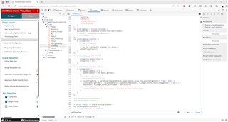

I use mmWave Demo Visualizer and check the data from AWR2944EVM.
I want to get the point-cloud datasets from the record data(dat file).
How can I get the point-cloud datasets from the record data?

    The mmWave Demo Visualizer webpage contains the source code that converts the TLV data received over UART and writes it into a .dat file. You can look at the source code of the same to parse and extract the point cloud data from the dat file. (Ref file mmWave.js)
    Kaushik
  • Hello, Mr./Ms.Kaushik
    Thank you for your answer.
    I understand what you say. But I want to extract the point cloud data easily.
    If you have the list of the data format in dat file or sample code to extract data, please tell me.
    Regards, Yuichi
  • Hi Yuichi-san,
    Looks like there already exists scripts for this purpose within the mmWave SDK (C:\ti\mmwave_mcuplus_sdk_<ver>\mmwave_mcuplus_sdk_<ver>\ti\demo\parser_scripts).
    I am attaching the same in this thread.
